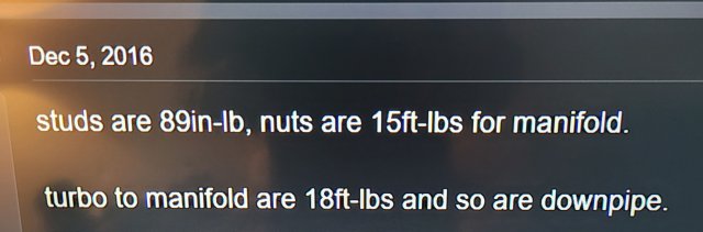

I found these in another thread. I am looking for values for the coolant and oil as well but nothing yet. From what I have read, most seem to just tighten and snug them up. See photo.
