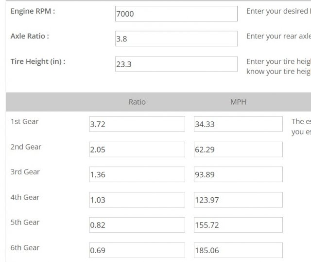

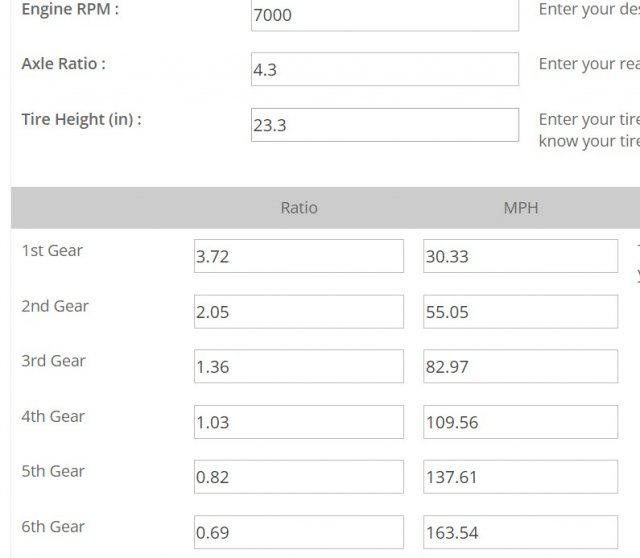

It's not a mod for everyone, that's for sure - however it makes the car accelerate quicker all around. The downsides are lower top speed (not relevant on this platform in my opinion), higher RPM when cruising on the highway, and more frequent shifting (more neutral than negative). Overall you gain stronger acceleration everywhere in the rev range, every gear.
I just did the calculation with my tire size, and your 4.3 has me at 140.62mph at 7000 RPM in 5th. That's pretty awesome, actually. I don't anticipate getting above 140 on many tracks. Maybe VIR on that backstretch, but definitely not on any of the three Summit Point circuits I visit regularly. Even VIR, I think I'd be tempted to let it bounce off the rev limiter for a second before threshold braking into that spot.
My car is full street car trim with no weight reduction (actually the opposite with a small sub and amp in the trunk). I don’t think I’ve exceeded 125 on the back straight, but I also haven’t been since I had OEM brakes so I was real conservative so I didn’t cook them. 140 is probably right at the sweet spot. Could always bump the limiter to 7200 if you’re comfortable with it.
