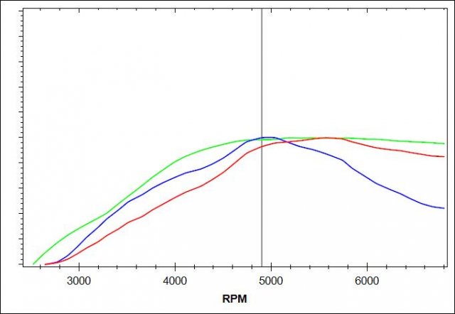

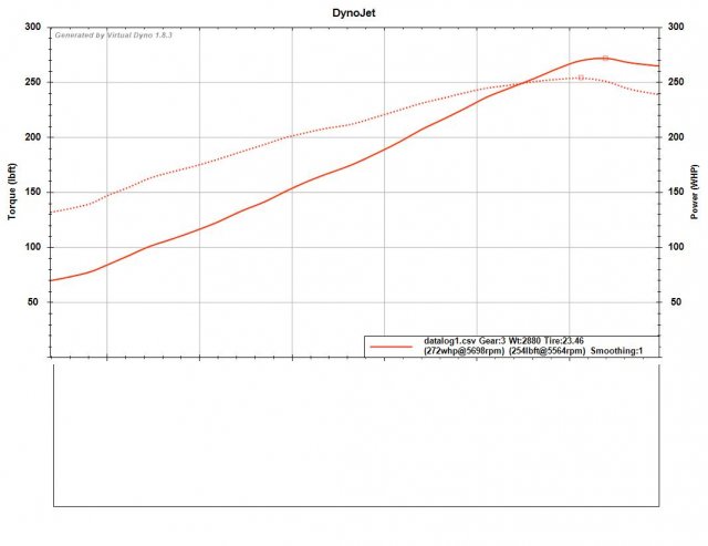

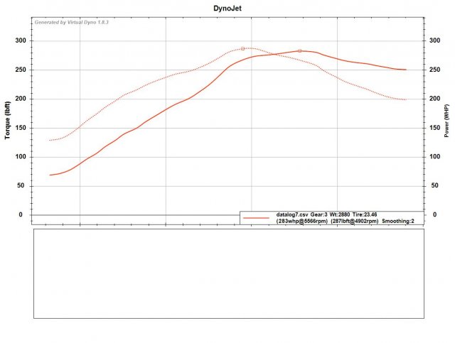

After a week of vacation I was able to get a few issues addressed and take a log with my first tune revision. My OEM plastic cold side intercooler pipe was leaking at the joint for the symposer so I ordered I whoosh cold side pipe, welded a TiAL flange on there and installed it along with the whoosh boost tap to replace the extra large ATP boost tap. I also went ahead and installed a TiAL actuator with a 16psi spring installed and here are the results of the first pull. This was at around 23.5psi.

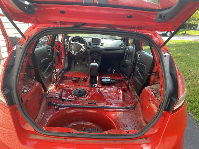

I was able to finish up the weight reduction today in prep to drop it off to have the rollbar welded in this weekend. Hoping what I’ve removed more than offsets what I add with the bar.
Wow baller, even removed the driver's seat. That's commitment to weight reduction.

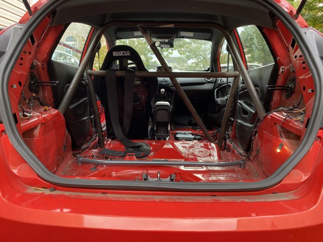

Hahaha, I have the sparcos ready. I’m dropping off for the roll bar install today and my guy will be adding sub belt mounts and lap belt mounts so everything has to be loose so he can take it in and out.

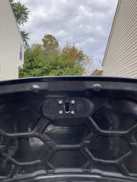

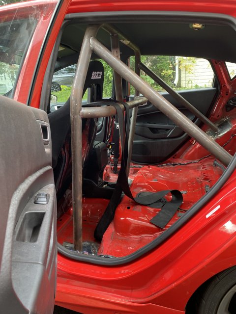

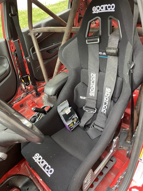

Been awhile since I check back in here.... The roll bar has been welded in and I just need to mask off the whole interior and paint it. The Sparcos are mounted and fit in the cabin great, although a little snug around the waist(I've probably put on a few lbs). I also went ahead and ordered a Ventus Veloce CF hood to replace my crumpled OEM one and I received shipping notification this morning. I also picked up some Anthracite TD Pro 1.2 wheels in 15x8 with 2 used up NT01s and 2 good NT01s so I'll be replacing two tires and putting them on the car for track days.
I'll snap some pictures of the current status tonight.
Don’t know what you’re planning on using for paint on the inside but I used bed liner. I didn’t want to look at bare scratched up paint and I didn’t have the skill or patience to paint match it lol. Pics don’t show it fully finished but I went just behind the carpet where the rear passenger feet area is. Very happy with the result.

I plan on using rustoleum texture black paint. I'm only going to be painting the roll bar/floor plates, my floors are actually in decent shape so I don't intend to paint the floorpan.

I spent the day yesterday tracking down and eliminating an exhaust leak that I thought was the downpipe-turbo connection but ended up being the turbo-manifold connection. Once that was fixed I took it out for a test run and datalog and here was how it ended up. It was a little wet out but it's still relatively close to what I should actually be making.
