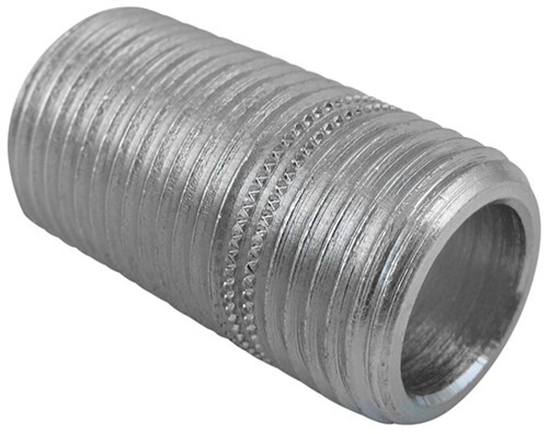

here's what I think might work for an adapter fitting to eliminate the stock cooler.
Once the stock cooler and it's adapter fitting are removed, screw this 3/4x16 fitting in to allow a oil cooler sandwich adapter to fit on.
then install this fitting (3/4x16) with the sandwich adapter to allow the oil filter to screw back in place.

From what I can tell the 3/4 x 16 brass nipple idea Koozy describes above is the best option. I plan to cut it to approximate length, run a nut and washer down on it to hold the sandwich plate on and allow enough length left for attachment of oil filter.

No, I believe the thermostic sandwich plate I bought would work with the correct adapter fitting but cannot seem to find a way to purchase only the 3/4 16 piece. Hayden apparently does not sell fitting alone and I do not want to purchase another sandwich just to get the right fitting.
