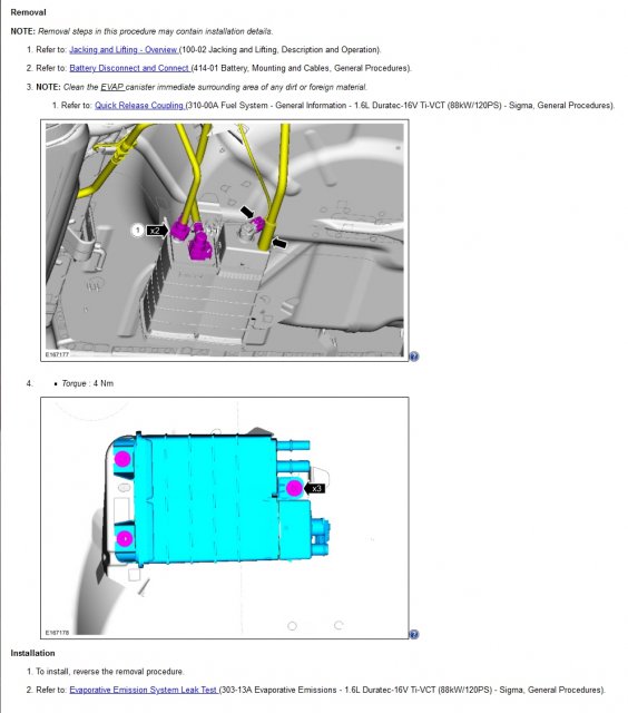

I just had an evap leak diagnosed and the shop said that one of the nipples on the Vapor canister broke. They quoted me a ton to fix it. I am just wondering has anyone had to replace this part themselves and if so how difficult the job was?

I replaced mine after whacking it on ice and cracking it. Its really easy to do. Just takes time and some wrenches.
