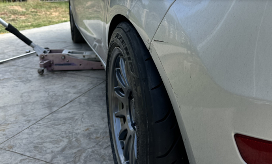

This is my fitment with 15x8 +28 with a 205/50/15 tire front camber is -3 and rear camber is -1.7 with just a small drop of swift springs. Wheels are already poking out front and rear. If I went up even one tire size I'd be rubbing all around.
What struts are you running? I'm on Bilstein B8 and noticed a much higher ride hight compare to stock even though I'm on Swift as well.
