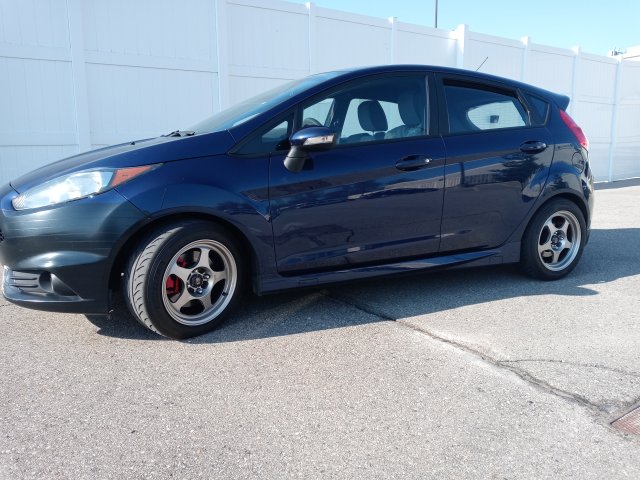

Sorry for being so slow to post the wheel images! The Slip streams are great.I am currently running on Dunlop Direzza Z3, 205\50R15. These were originally flat black. I repainted them in Rado grey. And, no spacers required for brake clearance. Super lightweight. Easy to balance.
20210419_092659.jpg Satisfactory width. Easy to clean. The very best sticky tires fit at the lowest cost per tire, compared to larger diameter tires. I have zero complaints.
