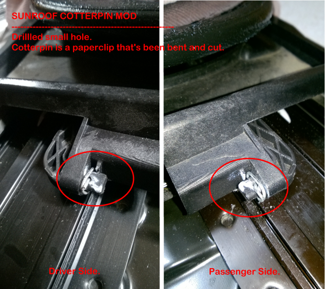

The tray just snaps back into place. I may make a slight modification, to help prevent a repeat; not that I understand what caused it since the module/motor can't be easily operated outside the vehicle.
Decided the modification that needed to be done with the sunroof, was to add a cotter pin. Photo below describes how this was done.
https://1drv.ms/u/s!ABsZJDCN8kMMgaxg

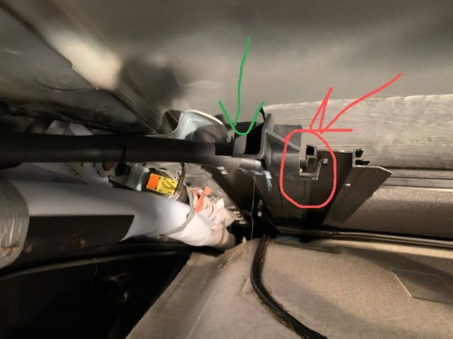

Hey man - I know this thread is from a while ago but I was wondering if you could help me out.
I just bought my 2016 ST about a week ago and a few days ago I noticed like a literal pool of water in my spare tire well. I've been in the process of tearing things apart to try and figure out where it is coming from. There was definitely some coming through these little plastic anchors where the torx screws go to hold the bumper onto the car, so I permatexed/RTV'd around those bolt holes.
Whilst looking for any other sources of leaks, I found that there was some water near the headliner which then dripped down onto where the rear shock bolts in. I pulled the headliner and poured water into the sunroof drain track and found that the driver side drain was draining properly but the passenger side was pooling up in the area before the drain line and then spilling over onto the headliner and below. Does this indicate that I need to remove the sunroof tray as you mentioned?
The drain line itself seems clear, I blew through it and it is clear. Some water dribbles through it, but a lot of it pools up before the line and then spills over the side onto the headliner. Any ideas for how to fix this?
The water pools up near the green arrow and then spills out over where the red is. (this is the driver side which actually works but the picture came out better on this one)

@speedyspaghetti -
Thanks for posting up with yet another source of intrusion for people to consider.
Yes, that is exactly what happens when the tray dumps the water into the track, instead of the trough.
Can you push your sunroof screen all the way back or does it stop just before the handle? If you can shove it all the way back, I suspect this is a possible indicator of that tray being out of place.
Just be mindful of whether or not you're dumping the water onto the track, versus the tray, versus the trough. The tray and trough are good. The track will dump into the passenger cabin.
EDIT: Note, not all of the water hits the track. Some may hit the trough, some may hit the track. There is a ton of caulk/sealant/glue merging the plastic end to the aluminum metal track. Be sure to observe what happens as you have it out of the vehicle. Maybe there's a chance you'll discover something we haven't seen/reported.
