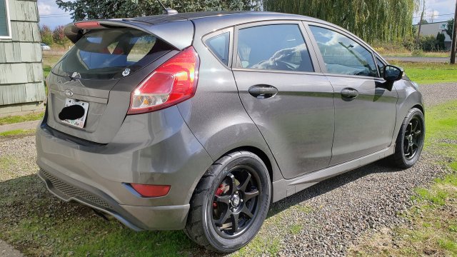

Another data point:
Stock tires are 23.5" tall
I am stock springs and run 215/40R17 so 23.8" tall
I was running 205/50R16 so 24.1" tall
Local guy here runs 245/45R16 (I assume on an 8" wheel) and he claims "barely any rub", this is a 24.7"
So a lot is possible, depending on what you do for suspension/fender rolling/wheel offset. Running a 9" wheel is going to push you outside the fender lip, meaning you need to go to flares (and cut fenders back), or sit high enough (with enough bump stop) to not hit the fenders on full compression.
#4150
14,808
7,268
What kind of suspension/ride height is he running with those and "barely any rub"?!?
#12368
314
269
Stock...(if I remember right)
and looking at the picture, I think that's a 7" wide wheel.

thats pretty far out if it's ty

that's impressive the guy can run 245/45/16 no rub.
I think the tyre is toyo r888r's and yes indeed there's a 245/45/16 size. Tire rack state sect width being 9.6. Tread width 8.5. Overall Diameter 24.6. promising to know he doesn't rub anything at all.
hard to say what wheels those are. I think the brand is Motegi. Dont see that design wheel on their site. However they do have some 16x7 in 4x108 at +35. Would be unconventional setup to say the least with stock suspension, 16x7 wheels, 245 tires (would think it'd be too wide for wheels) and on 100tw track tyres no less haha. Crossing my fingers he really doesn't rub. Even better if he runs more aggressive camber than -2 fronts.
