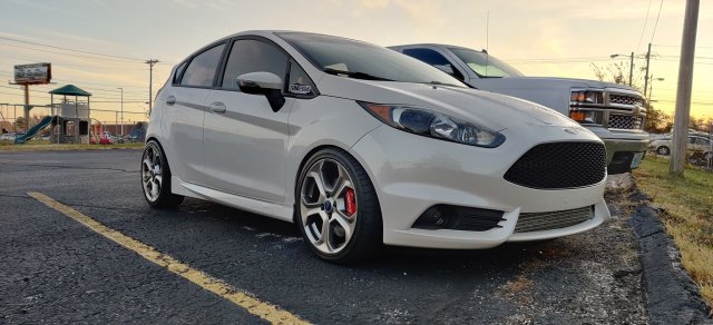

You can run a 20mm spacer safely with extended studs. ( i dont like the ones that bolt to factory studs and then have their own studs to mount the wheels, seen a lot of wheels come off) or you can run a 7 inch wide wheel with a 20 offset. Or an 8' with a 30.
This being said i would not run them in winter. I did it and the snow and ice had no room to escape the fender well and ended up always dragging on the tires. It sounded horrible and murdered my rear fender liners. I dont have mudflaps. Which could only compound the space issue. Id say if youre gonna run agressive offset. Get yourself a proper set of steelies and snow tires, and save the good stuff for summertime.

I went 15 in the front and 20 in the rear and the fitment was damn near perfect to me. Even the 15mm in the front rubbed a good bit
