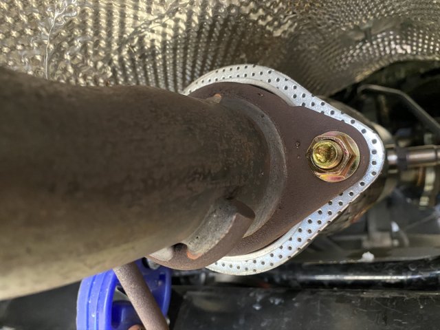

When we (my friend and I) got the OEM downpipe off (a real PITA) and lined up the new one, I noticed that the provided exhaust gasket does not line up with the flange of the stock catback and doesn't look like it'll make a seal, which, admittedly, should have been expected, except that I assumed based on my convo with Ron and the limited info on the product description that it would fit both a 3" exhaust flange and a 2.5" flange. The info Ron provides in this thread above also seems to imply that the provided gasket will work fine when he says:
As you can see from the photo above, the gasket doesn't line up with the flange. Obviously a major exhaust leak would occur installing this way.
