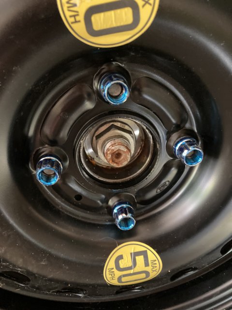

rotated my tires today, which have gorilla spline lugs from the previous owner. Tried on one of my 15" steelies to get ready for winter and did not like the way things mated up. The open ended design of the lugs seems like it could promote corrosion of the lug bolts, and they only turned about 4.5x.
TL;DR what lugs do folks use with steel wheels? Also, any center caps you'd recommend?

Are you using a Wheel Spacer to mount the Steelies" If so DO NOT DO THAT. Just 4 1/2 turns on the Lug Nuts indicates that the wheel studs are much too short. My experience is that steel wheels feature the lowest nut seat height of any material wheel. Thus my question about wheel spacers. If you not using spacers you have a much more serious problem and need to get every wheel stud replaced before the wheels come off your car. BTW, with open lug nuts the wheel stud should pass completely thru the nut when the wheel is mounted and tight.
Personally I've always preferred open lug nuts specifically because they do reveal short wheel stud issues. As for rust, learned to drive in the snow belt surrounding Cleveland, Ohio where 12-18 inch snow events can be typical. So lots of salt exposure and not once did I ever have an issue with the lug nuts rusting in place. For that to happen it takes many years of that wheel being untouched and I do not think you will so that. All I ever did was apply a dab of grease to each stud and nut. after the wheel was mounted.

Thanks - no axle spacers.
The 4.5 turns was with the steel on the spare today, as a test for winters. My 15/52s are more like 8-9 turns and I always use threadlocker.
Part of the issue is the deep beveled recess for the 15/52s v what looks like the opposite on the steelies - that’s why I was thinking the lug nuts might be an odd shape (Gorillas).
I’ve got a pic here…

After doing some reading, it looks like my problem may be that I'm using the conical lugs that work well with my 15/52s but seat terribly onto the steelies.
SO...any mag type lugs that folks recommend, since that seems like it will seat much better with steel wheels? (And since I've heard the stock lugs are terrible)

Reviving this thread since I never found a solution for center caps on the steelies. The problem is the axle shaft sticks out too far. Are hub caps the only way to protect the shaft and axle nut from the elements (namely: salt)?
#3591
82
102
It's almost spring, but for next year double check the inner-diameter of your steelies' hub opening and pick a taller center cap from this vendor on Amazon. Lots to choose from, including some taller ones that look like they would probably clear the axle shaft. They have a hole though, so some kind of decal or plug would also be needed. Opportunity for a domed decal from Etsy or something to dress up the steelies, maybe.
