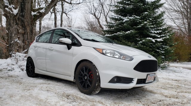

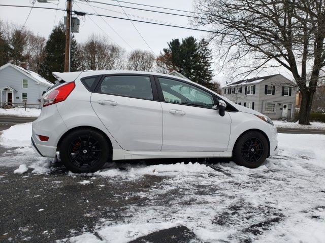

So I ended up getting some 15x6.5" wheels new and I found some used 195/60R15 winterforce tires for free! Do you think they will fit? I know the overall diameter of these tires is a little bigger than stock but was hopping they would work because.... free!

I’m running 195/55R15 winter tires. I think yours will fit unless you’ve lowered the car quite a bit. I also have no TPMS. The light is always on but no beeping or anything overly annoying

I have 195/60-15s on 15x7 wheels, no rubbing/scraping or contact at all on the factory suspension. A 6.5" wide wheel is FINE for that width tire as well. [thumb]
