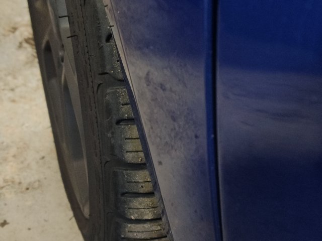

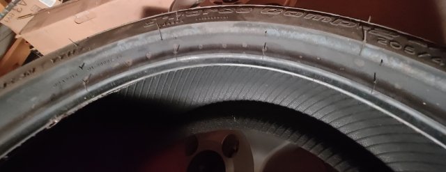

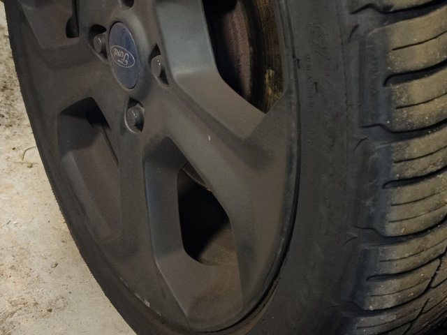

Comment might be a little late,
but I especially like the BFG Comp 2 A/S+ 205/45 17, because the sidewall rubber is thicker & sticks out a little further past the wheel lip to act as a built in wheel protector against light/slight curb rubs.
The taller profile + rim protecting sidewall = 205/45 BFG's as my go-to for the factory wheels.
You can see the extra thick lip and how much it sticks out past the wheel edge in the pics
