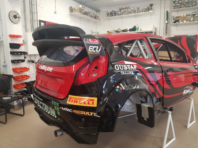

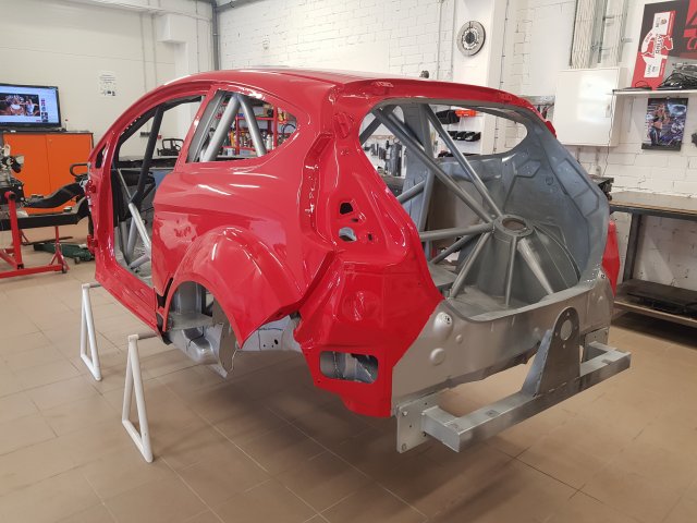

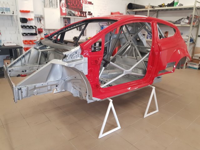

Hello everyone,
Although I am on the other side of the globe, I found my way here through some searches concerning 1.6 Ecoboost engine builds. Long story short, I am now posting our rallycar build here. The team we are operating is named Kaur Motorsport.
As to this date, the car is only using the engine and the body from ST180- I apologize if that is not enough of ST180 parts to qualify to this forum(or for your personal taste). But it seemed to me it is the best place to find likely-minded people where 1.6 Ecoboost is involved and I could also accumulate more knowledge myself through some discussions.

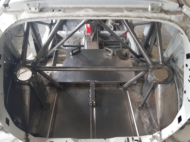

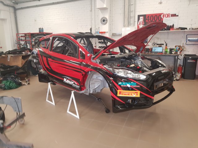

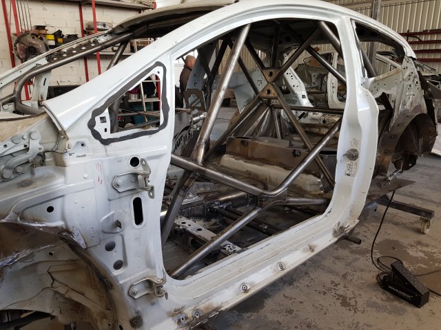

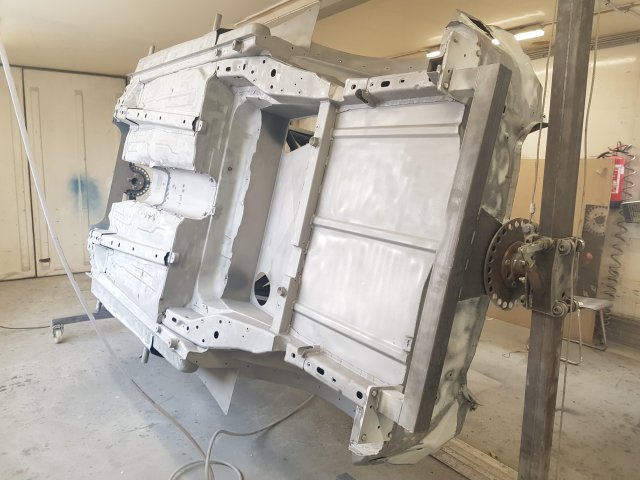

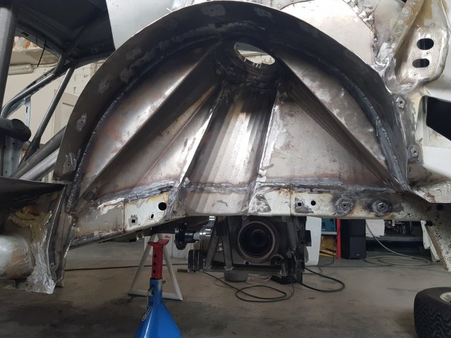

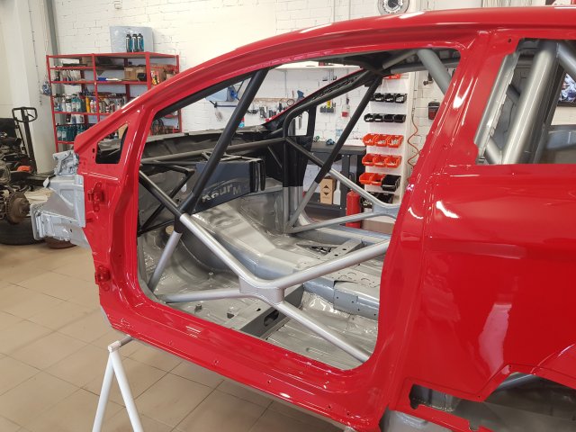

I will start with the body and what has been done:
1. Completely stripping the body and removing unnecessary components.
2. Modifications to the body to install R5 bodykit and custom suspension. Container for homologated ATL fuel tank.
3. Installing a TIG-welded CrMo rollcage kit with FIA approved homologation. Custom steering column attachments to move seating position towards the rear of the car.
4. New tunnel to accommodate the propshaft.
5. Mounting points for custom subframes, engine and transmission.
6. A lot of smaller modifications.
7. Glass blasting.
8. Paintwork.
In every area we were working on, the keyword has been weight. Haven't done it yet, but I am even now thinking of lighter nuts and bolts. The idea of the car is to get the same level of performance as an R5 rallycar, but at half the cost.
Feel free to throw any questions at me. Will post about the engine and transmission next, with the engine being particularly a roller-coaster ride so far and still a development in progress.

That's great, I need one of those!!! Too bad you couldn't make some of the sheetmetal like fender liners out of aluminium alloy bonded/riveted instead of steel. Or carbon roof. Being in motorcycle racing for over 20 years, I get the hardware tactics, especially for unsprung weight, weight on the nose, or weight up high. I've hollow drilled a LOT of titanium hardware on the lathe. Seems like most bang for the buck would be caliper bolts, wheel studs, suspension bolts... they make some low cost alternatives for circle track racing such as interesting looking bolts made from threaded tubular chrome moly steel, heat treated... might be a consideration for large hardware for engine compartment, not sure about suspension for a rally car. Also move as much equipment as you can further towards the center and down low, everything on the car evaluated for lower position and more towards the center... great stuff.
Replacing some steel with aluminium is a good thought, but as we mostly run on gravel, for body components we need to make sure we still have proper seal against dust and proper protection against wear. Same goes for load bearing bolts and nuts, we need to think of reliability as a similar priority, the gravel surface creates some massive dynamic stresses on different components. 180 kmh between trees, you really don't want suspension bolts to fail. But tubular chrome moly bolts are a good idea in some other areas, something I will surely look into, thanks!
