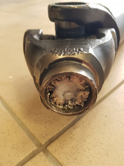

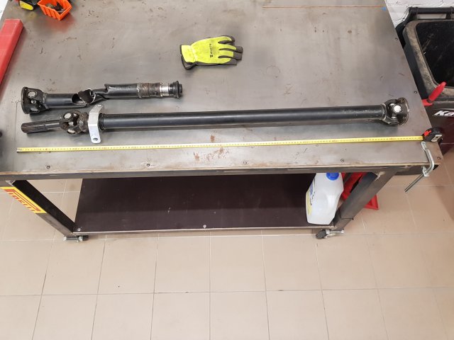

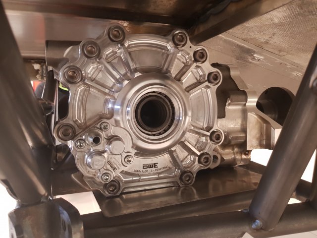

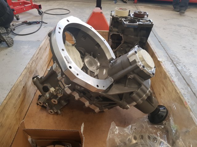

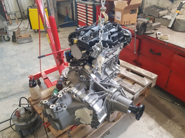

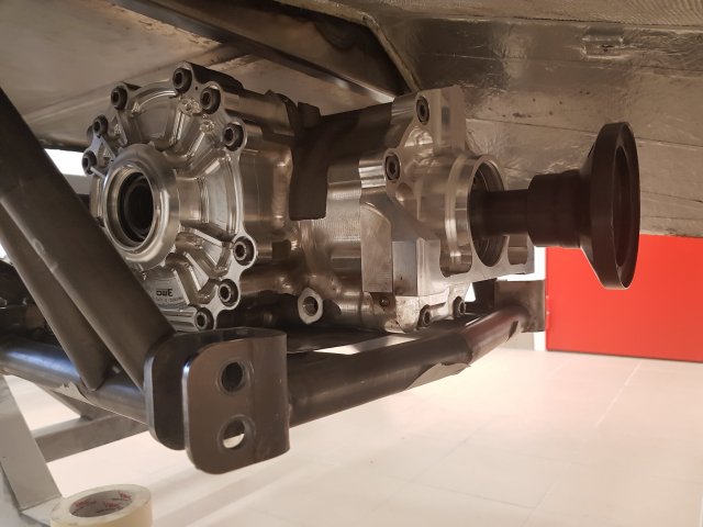

We are using 3MO gearbox/transfer and rear diff. You don't want to know how much they cost, they are the most expensive parts on this car. :D

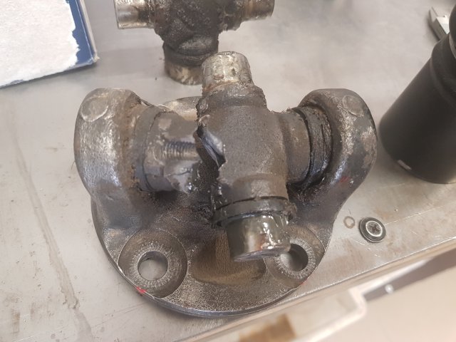

Even then we ran into a serious issue with the propshaft. We made a similar propshaft as the R5 Fiesta has, but they kept breaking and twisting on launched starts. Everybody were saying our Ecoboost is too powerful, although we were running the stock internals engine. :LOL:
This propshaft should have easily handled 400hp/600nm.
Turned out 3MO forgot to mention an important bit of information for those transmissions- they basically use 1:1 ratio front and rear. 1 revolution at the wheels is one revolution for the propshaft.
After we changed to joints and tubes more familiar from small trucks, this issue got resolved. The forces going through the propshaft were just 3 times bigger than you would normally see, where 3:1 ratio is used.
20190307_095945.jpg 20190307_130216.jpg 20190307_170748.jpg 20190311_153151.jpg 20190205_121511.jpg 20190205_121505.jpg 20190716_170707.jpg 20190717_143101.jpg 20190818_152610.jpg

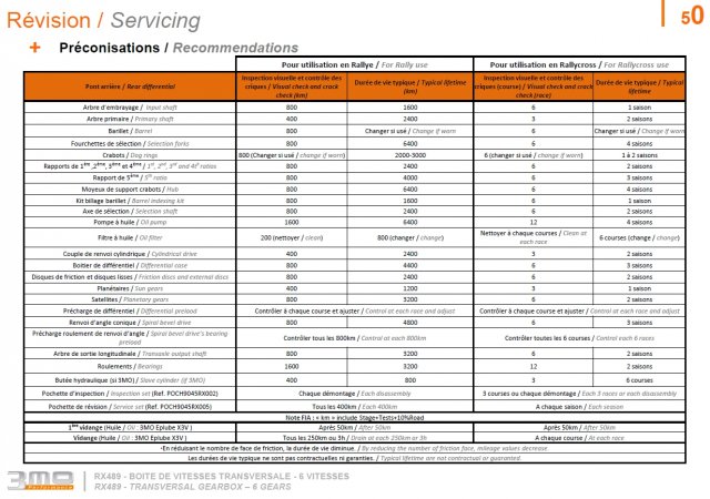

TyphoonFiST- I guess it was well hidden between the lines :ROFLMAO:
JDG- SSkm is Special Stage kilometers for short. Mainly used on the rallying scene to measure life expectancy and rebuild intervals for different components. Basically all the km-s where you are pushing the car to its potential, we measure as SSkm. Different producers also give different additional formulas for calculating it. For example French gearbox manufacturer 3MO gives a formula of: SSkm= stage + test + 10% road.
