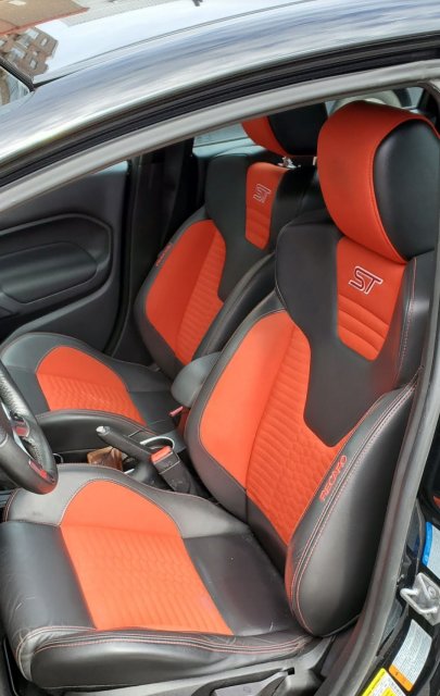

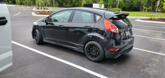

Figured it would be fun to document the process of how I ruined a perfectly good Recaro-equiped Fiesta.
I have a bunch of my incredibly amateur driving events on YouTube if you like watching FiSTs race: https://youtube.com/@djchameli9165
When I bought this car, I made a promise to myself that any mods I did to it I would install myself (unless it involved opening up the engine or transmission). I wanted to keep it from turning into a money pit like my 335i. To my credit, I've stuck to that, with the exception of the LSD, clutch, and alignment/corner balancing.

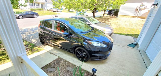

4/4/20 - I bought the car used with 33k miles for $14.5k. I traded in a 2008 Honda Fit (hence the transferred "Jazz" license plate) because, although it was fun, the lack of a highway gear and Android Auto was a pain when driving 5hrs roundtrip for work

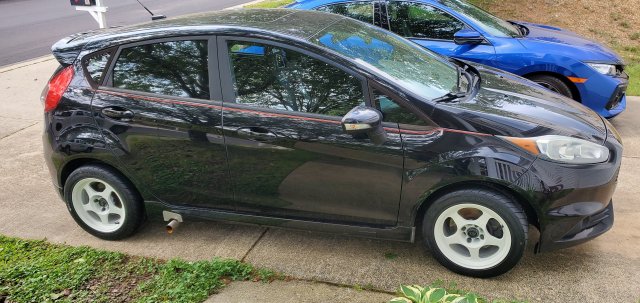

5/10/20 - I picked up some 16x8 Konig Dekagrams and some crappy Federal tires

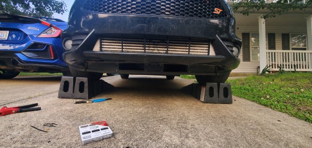

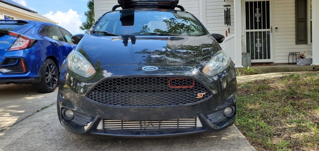

6/8/20 - cp-e intercooler purchased and installed along with the Mountune short shifter and a Cobb RMM
At this point, I was planning on doing minimal mods to the car and to keep it relatively stock as it was my daily driver. I stuck with it for a surprising amount of time in retrospect. But, as it always does, the upgrade bug got me. I decided it's much cheaper and MUCH less stressful to race and beat on a Fiesta than it is my garage queen GT350. Upgrades started getting more frequent and severe after this.

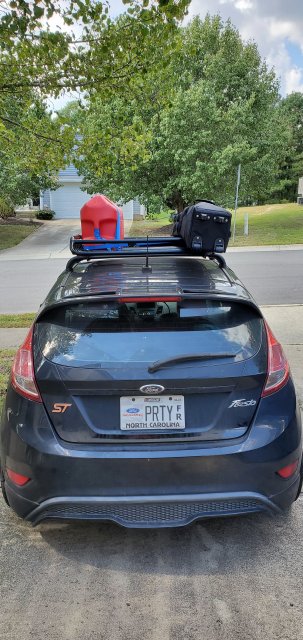

9/23/21 - Picked up a roof rack and basket because AESTHETIC

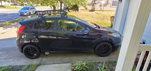

11/24/21 - I had been running a custom side exit exhaust for a little while now and figured I should get a proper exhaust to swap in for when the drone got to be too much. I went with the Milltek non-resonated exhaust. I loved the side exit too much and only recently switched to the Milltek within the last 2-3 months

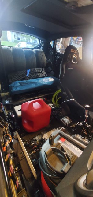

4/20/22 - Big life changes in the form of a new company which brought the benefit of a company vehicle. As the Fiesta was no longer needed as a daily, I got to fulfill my dream of turning it into a track focused car. Sparco bucket seat and all associated hardware ordered. This was huge and let me drop my seating position by several inches. I'm 6' 1" and with a helmet and the seat at it's lowest position, my head would hit the roof

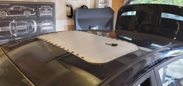

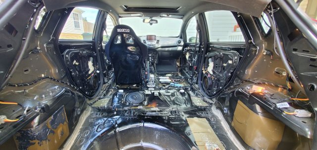

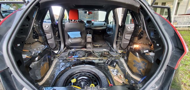

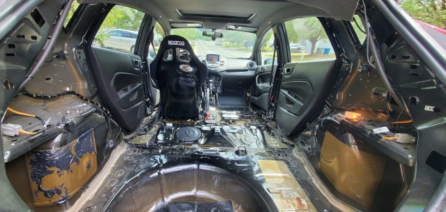

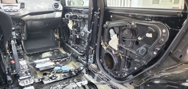

4/27/22 - The gutting begins. I took out a little over 280lbs out of the car from what I had measured. This doesn't factor in the sunroof so the actual number is a hair over 300

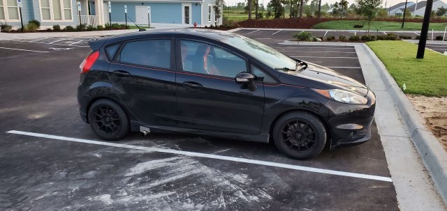

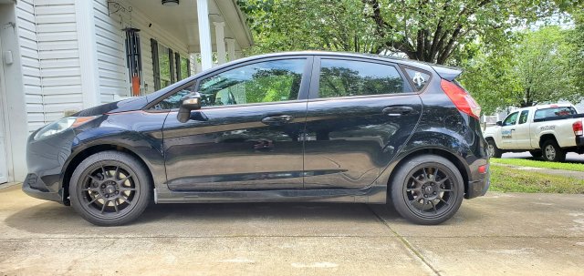

5/11/22 - Got H&R Super Sport springs. These were the lowest drop springs I could find and I desperately needed them after gutting the car. The rear looked like I had a lift kit on it, and even with the H&R springs, it still sat a bit above stock ride height. I only installed them on the rear, still ran the stock springs up front

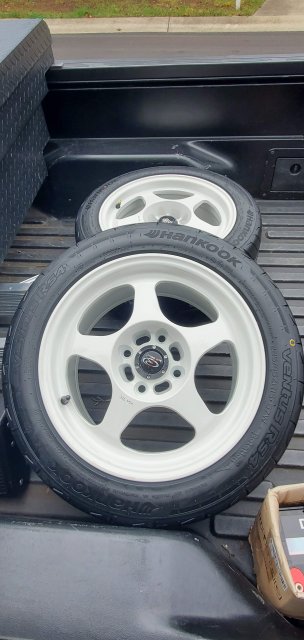

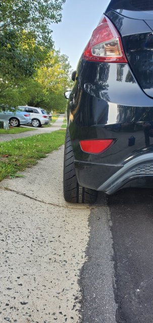

5/17/22 - First big, big upgrade in the form of an MFactory LSD and also some new tires, 225/45R15 Hankook R-S4s, to replace the absolutely trashed RE-71Rs. You may be saying "But those will not fit on your 16" Dekagrams" to which I say "Correct!" Dekagrams were sold to dhminer replaced with some Rota Slipstreams in 15x8. I also installed brake ducting up front to help the stock brakes out a little bit
5/31/22 - Installed DPro's camber plates to help with shoulder wear on the rear tires

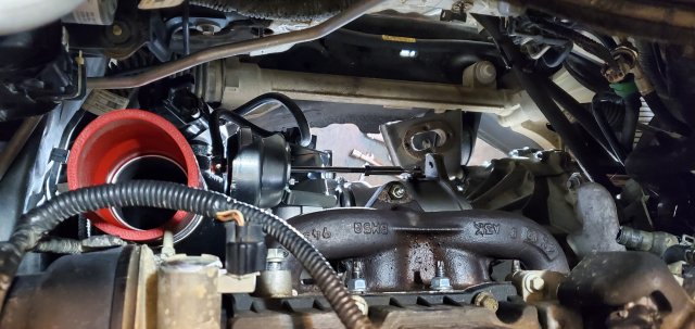

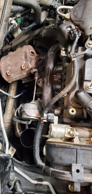

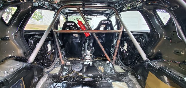

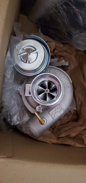

6/7/22 - The big day. It finally arrived, my S280 turbo upgrade. This would sit in the bag in a box for 3 months. Hey, I had a baby, cut me some slack. Oh and I was busy cutting, fabricating, and welding in my Autopower roll bar.
7/11/22 - Passenger Sparco seat ordered and installed
7 through 8/2022 - Worked on the cage when I had the time, it was very slow progress and took me more time than I care to admit. It's done. Fully installed, painted, the whole 9. Never again...

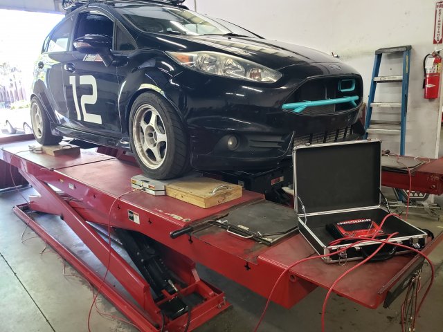

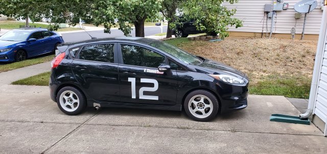

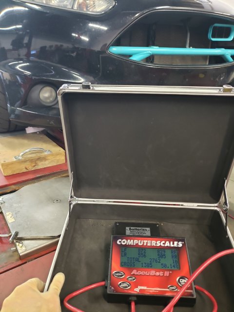

Getting the corner balancing done
These weren't the final numbers, but I had asked how much the car weighed as they were working on it. 2762lbs with a 175lb driver, the spare and jack in the rear, and the roof rack I forgot to take off. Should be right around 2500lbs empty car. Rocking that 62/38 weight distribution though

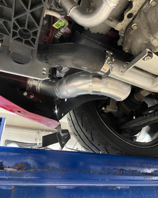

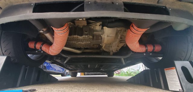

While the brake ducts located in the lower spoiler seem like a good idea, they got smashed the first time I went over the curb at Barber. Then one got ripped off the second time. Learned that lesson the hard way and went ahead and built some that duct from the fog light holes. FDD6ACAA-4FA5-4E52-B16E-990F5F84E43A.jpg IMG_1332.JPG
lol, dang. i was like "hold the phone...you can run the brake ducting that low?!"
i see you're putting that $1K welder to good use (y) (can still be putting the welder to good use but was commenting on Fusion Works' brake ducting work)
They surprisingly don't scrape and look MUCH lower in the picture than they actually are. I've tweaked the angles a bit since, but for the events that I have run, I haven't had any issues with them.
Yeah, the welder came in handy for the cage and my jank side exit. I'll have to try and clone Fusion Works ducting next. I also welded up some brackets for the 6 point harnesses. It's very similar to this for the S550: https://shop.watsonracing.com/HARNESS-LAP-BELT-MOUNT-p/wr-harnessmnt.htm
Mine was just two 19" sections of 2" x 3/16" steel with a 3/4" lap stitch welded on both sides and then eye bolts mounted at the corners for the lap belts.

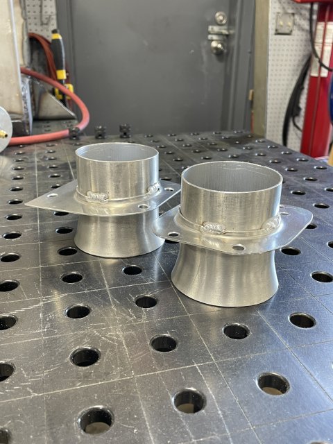

Damn those welds look terrible. HAHA
Hey they may be ugly, but they work! :ROFLMAO: I'm curious where you picked up those flanges though. I thought about doing a fog light to duct conversion, but wasn't sure where would be best to begin.
Didn't realize he was talking about your welder. Oops
The driver side seemed to hold up OK, the passenger side that has to go under the engine wasn't as fortunate. Also when driving in a snow storm those brake ducts will pack full of ice and snow. HAHA It takes more than one session at NCM to actually melt the ice out.
I was referring to the welds in my pictures. HAHA. I didn't realize how bad they look. I made all of the pieces for my brake ducts. The flanges are .062 aluminum sheet I formed to weld to the aluminum tube. They should work better than the under ducts. I melted a set of BP20 pads at Barber and NCM with the under mount ducts. You get better packaging through the bumper and fog light holes. You will lose the washer bottle though.
I think he thought the fog lightbreak ducts were mine? Not 100% sure.
Fortunately I don't need to deal with snow too often down here. It's a blessing I've come to appreciate being from up North. The passenger side taking more of a beating is definitely something I've noticed.
I had figured you were talking about your welds, only because I didn't post any close-ups of my own 😁 I got to say those flanges look great, I'd buy a pair if you sold them. And I've already deleted the washer bottle, so no concern there!
