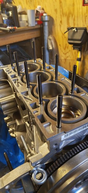

I'm an idiot. Engine is blown, cracked cylinder 4. So what's the plan? Well how about being a total doofus and building the short block myself, just because I want to. I'm not a mechanic, but after pulling and installing the engine a few times already, dismantling it and learning alot along the way, I thought the next fun thing would be: Build my own damn short block. As stated, yes I am an idiot, no question. But I also love tinkering and learning about this stuff. And I do have a 2014 Fiesta Mk7 1.0L EcoBoost to ride in while this i ongoing.
09-12-2023
Update, I did this silly thing and started an engine build. Got a stock Ford block brand new from PumaSpeed.

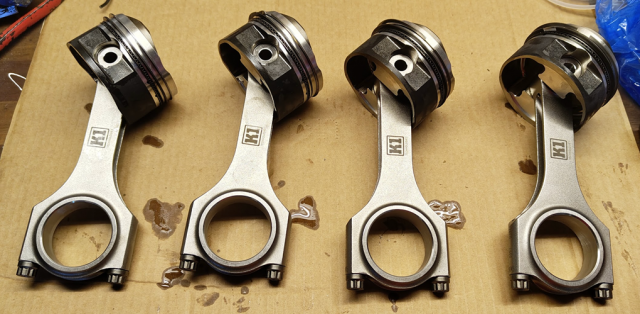

Wiseco Pistons and rings. Stock 79mm.
K1 Connecting rods.
KING Racing CR4365XP STD - Rod bearings
KING Racing MB5009XP STD - Main bearings
ARP 251-4302 - headstuds
Pistons and rods with rings ready to go in.

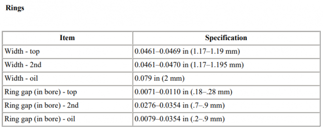

Off the bat when gapping the piston rings. 1st ring, spot on factory spec at .23mm. 2nd ring was .45mm from Wiseco. Odd as the factory spec says .7 - .9mm. Far off. Wiseco points out the second ring gap just needs to be greater than the first. Then all would be well. I then proceeded to gap them into factory spec and hit all 4 from .7 to .8. Any thoughts on this? If factory spec decrees .7 - .9mm I should be more than good.
Had me wondering, so I took off the second ring from my old borked engine. It was a refurbished one from eet-engines in the Netherlands. It didn't even look like they cared to gap them at all as they were around .4mm gap on the second ring.

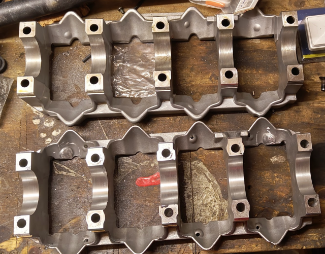

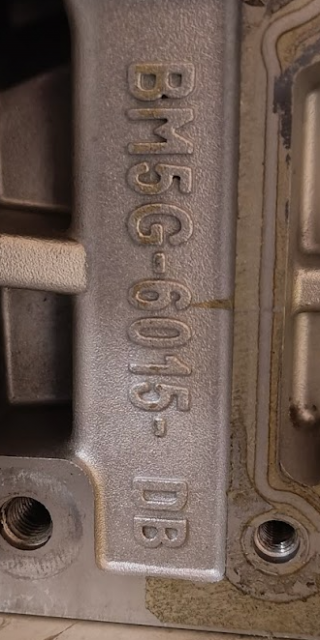

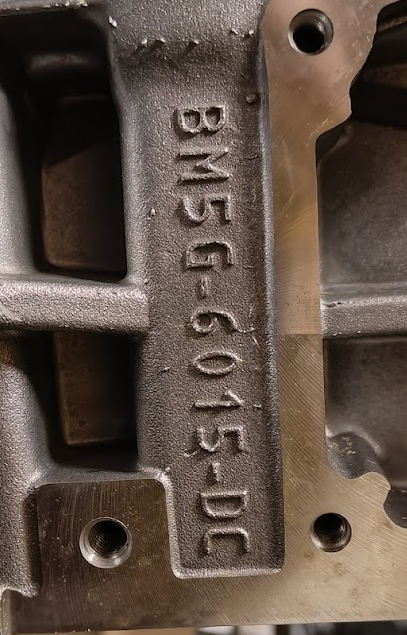

New issues arise. Anyways these are minor issues and to do with block revisions.
Have fun reading if you find these kinds of things interesting.
Old block: BM5G-6015-DB
New block: BM5G-6015-DC
No obvious differences in the block, but the girdle/maincaps are 2 different revisions.
Old girdle: 6334-BB
New girdle: 6334-CA

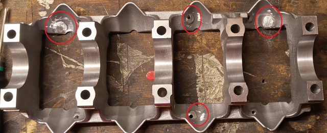

These 2 have some significant differences. Including bulges for some other application, molding or whatever reason. I hit this specific issue, there's 4 bulges that impede K1 rods with ARP hardware to rotate due to increased bolt size, in cylinders 1, 2 and 4.
https://www.fiestastforum.com/attac....59798/?hash=dc980823205b1e130513c366183ca378
Old top, new bottom(I only have a picture after I started grinding the bulges down to fit K1 rods with ARP hardware):
Just handling these 2 I noticed quite a significant difference in weight.
Old: 2842g
New: 2010g
Quite the weight savings.
Anyways I quickly ground down the bulges:
I will give it a final pass with some 120-180 grit when I confirm it's enough. But before doing that I need to plug up a bung inside the block for which I'm waiting for a specific BSP 1/4"x19 cutting tab. Yes I have threaded bungs for this and they all need threads cut.

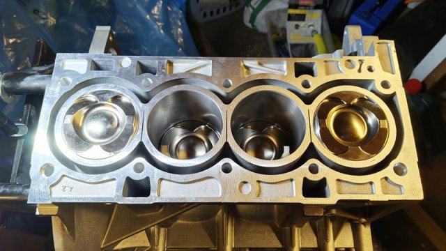

Finally got the shortblock finished. The girdle has around 3-4mm clearance on the rod bolts with my grinding done. Nothing hits and should be fine. It should not grow enough to actually hit anything.
Rod side clearance on these rods were around 0.20-0.23mm. Should be acceptable.

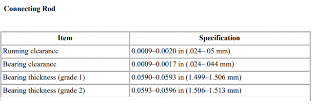

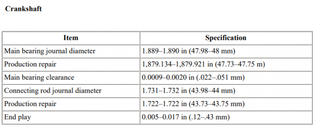

Rod clearances, measured with plastiguage, are between 0.035-0.040mm perfectly within specs.
Mains were within spec as well with around 0.045mm. I can't remember the specific numbers other than in the mid-to-high clearance area as I measured it weeks ago.
Plugs got threaded and plugged. With a dab of Victor Reinz oil and coolant safe gasket to ensure no leaking.
Next up, get the head from the old engine pressure tested and if needed, skimmed.

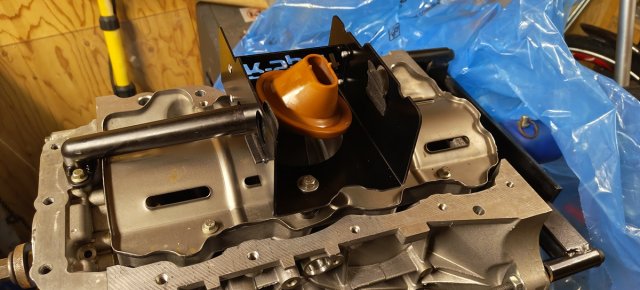

Plopped in the oilpump, splash guard and oilpickup and an R-Sport baffle as well. When I got it the rubber guards where on the outside of the baffle. Making it hard for oil to enter and easy to exit rendering it counter productive. Contemplating just removing the rubber guards. The baffle ought to do enough without them, removing an extra point of failure if they ever were to get loose.
Now I'm waiting for a new rear crank seal as it wasn't included in the "all gaskets" kit from PumaSpeed.

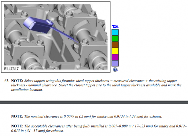

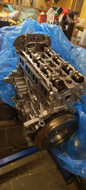

Removing old gasket material from the sump, with all the little curves, knooks and crannys is a real PITA. Spent almost 2 hours cleaning the old gasket manually from the sump. I have to get one of those gasket wheel things for my drill. Would've made it soooo much faster and easier.
Had a little issue with the valve tappets. It's the old head from the old engine. Didn't overheat, but I got it skimmed and pressure tested to be sure. It's in good knick.
Had to measure and adjust for clearance since I took it all apart to get it tested. I got everything within spec except for a single exhaust valve. Was .25 -.28mm and needed to be between .31 and .37mm
The smallest tappet I had was 2.975, so went directly to Ford and got a .2900 and 2.925. Ended up using the 2.900 for .33 -.35mm clearance.
But got it all within spec and got the head installed with ARP studs and Victor Reinz headgasket. Better production quality than the OE Ford I also have. Next job is cam phasers, waterpump, timing belt and it really is shaping up to be a complete engine. I know I'm slow, I don't work on this every day or even every week. It's a stress releasing hobby for me and I use it to clear my head from everyday stress.
