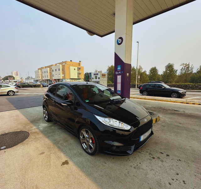

Hi, im Rafa
Looking for opinions on what shoud i buy braking wise for the fiesta st mk7, im not a track guy, (can´t afford it), i use my car on the back roads just to have some fun, but i feel that my brakes dont hold on very good.
Hope you guys can help me out with that, looking for opinions on brake disks, brake pads, brake calipers, brake fluid, and other recomendations.
My car is completely stock:
Thanks.
