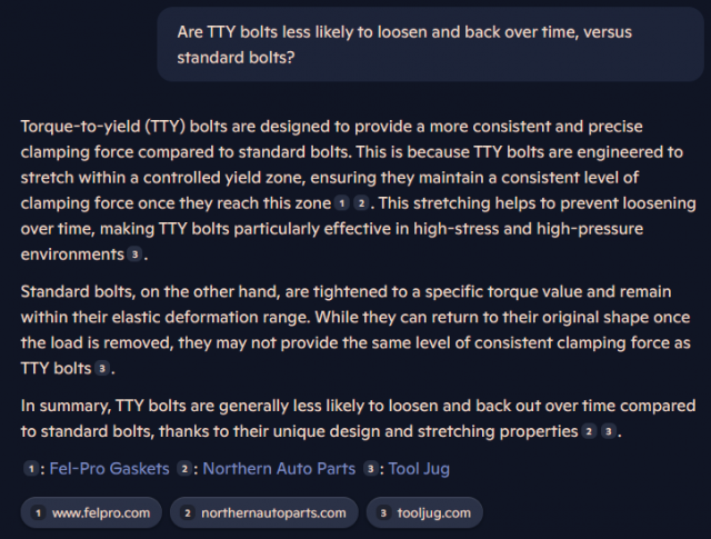

Did you replace the crank pulley bolt and crush washers when you did this. Both are single use only items and trying to cheap out on this has the potential to blow up the engine. BTW I LOATHE Torque to yield fasteners. It's just a really crappy means to save a dollar or two.
I've known AI to misinterpret and/or literally make stuff up when it doesn't really have an answer to a question. (much like its human engineers I suppose) But do you agree with this interpretation? I reviewed the links and TTY does make sense for certain applications where even force between multiple bolts is needed. (this is obviously a single bolt) I did have a non-TTY crank bolt back off on a prior car, resulting with timing issues on the harmonic balancer. But the real reason that occurred was my failure to put that to FULL torque spec.
1740622927455.png \
Sources:
https://tooljug.com/torque-to-yield-bolts/
https://northernautoparts.com/blog/tty-bolts-demystified-a-professionals-howto/
https://www.felpro.com/technical/tecblogs/tta-vs-tty-bolts.html
