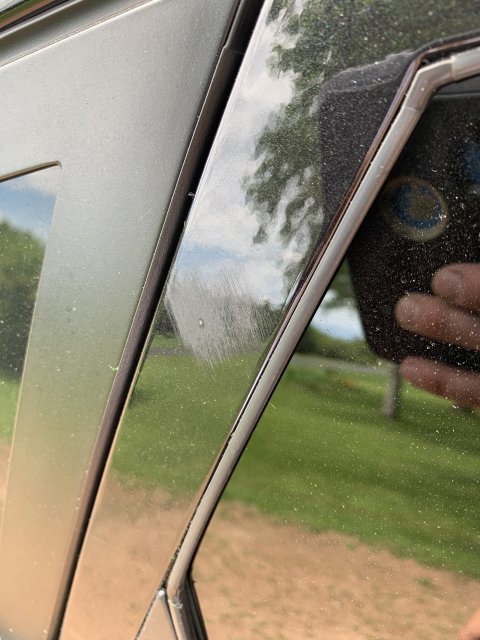

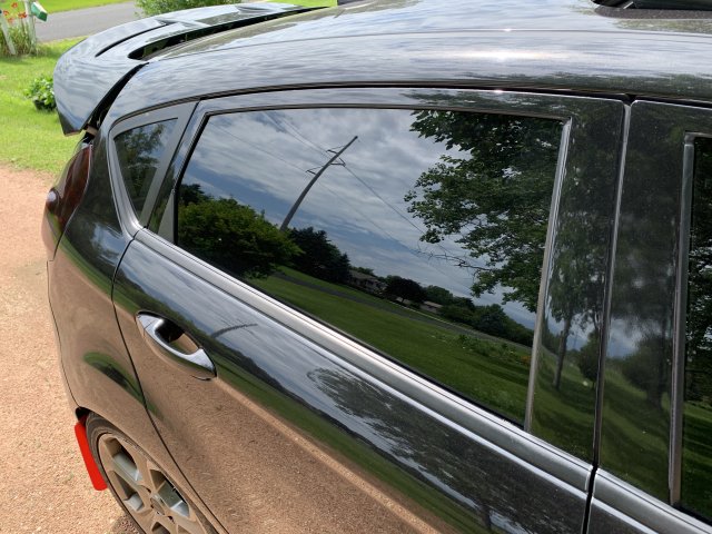

Decided to grind out the rear lower valance honeycomb and remove the weathered/aged plastic or vinyl whatever around the windows today. Bae just started to do the windows which was nice! When I took the bumper off I was SHOCKED to see how horrible the rear crash bar had rusted... I’m pretty sure shouldbeeasy mentioned this too. You where right! So painted the crash bar and touched up some rusty spots on the body while I was at it. Painted the lower center body so wouldn’t see primer through new bumper valance cutouts.

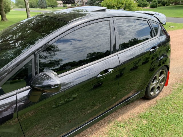

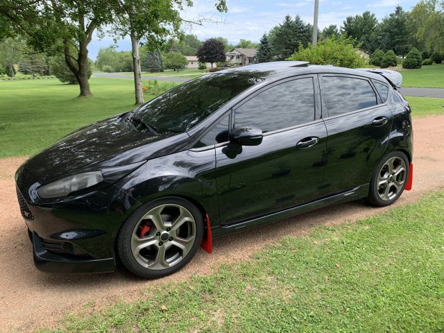

Can you post a side profile picture of the entire Fiesta? I’m curious to see how it looks without the vinyl sticker trim around the window. So far I’m liking the cropped photos.
The vinyl sticker on mine was pretty weathered and I just spray painted over it last year. I might go your route and just take it off.
Yeah for sure, I’ll get to it after work. It’s dark and and just left the shop for the day :) It’s just factory paint underneath it. So yours would just be factory fresh black under there! Mine did, however, have a scuff mark like the factory metal had a blemish that they sanded out. Yours likely will not have that issue, but an imperfection underneath there IS possible. Even with the one scuff mark, it’s still worlds better and an improvement over the nasty stained and faded wrap. I’ll shoot a pic here this evening/afternoon once work day 100% 👍
