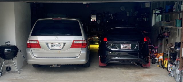

Winter prep! I didn’t think I could get both of these cars in here but put a lot of stuff in the attic and basement crawl space. I’m leaving this parked all winter and am terrified the wife will run into it parking lol... we shall see. Also final debating on Peron vs Stratified auxiliary fuel 4port - going to be pulling the trigger tomorrow... any further suggestions from anyone?

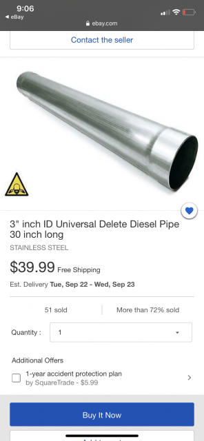

I should be able to cut out my resonator and fit this delete pipe and clamp it on, correct? My exhaust is stainless so it needs to be TIG welded for a proper flanged removal, which would require me going to a shop. Not really looking to spend 100$+ for a resonator delete. I want to remove 1 of the 2 resonators from my injen exhaust... it will be the resonator closest to the down pipe.

I so wish that I had a garage to work in!! [:(]
That shaved rear valance 'grille' looks really good, and it might even help keep it cleaner, since the 'cells' are now not closed, and will not hold onto the dust, pollen, road grime, and water as readily. [thumb]
Same here, I just swapped my engine and transmission in my townhouse garage and I had to leave it hanging halfway out the door to have room! lol... Agreed on the possibility of it staying cleaner back there, I was amazed how rusty my front crash bar got when I pulled the bumper for the intercooler swap this week. I shudder to think what the rear looks like at 145k miles on a 2014. :eek:

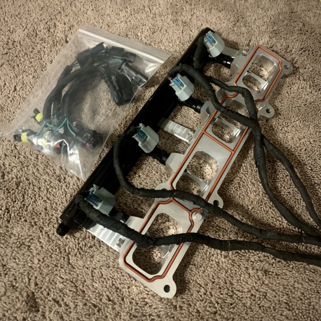

Finally picked up an aux fuel system... got it second hand. Now I just need to get an uprated MAP sensor and a map sensor adapter.... so close now. Next spring will be up and running.

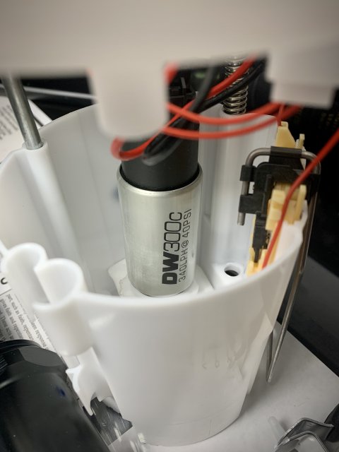

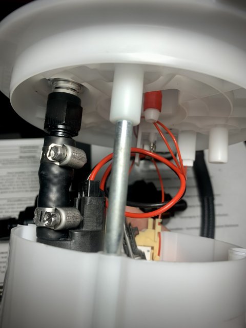

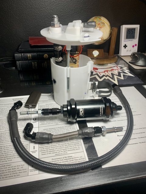

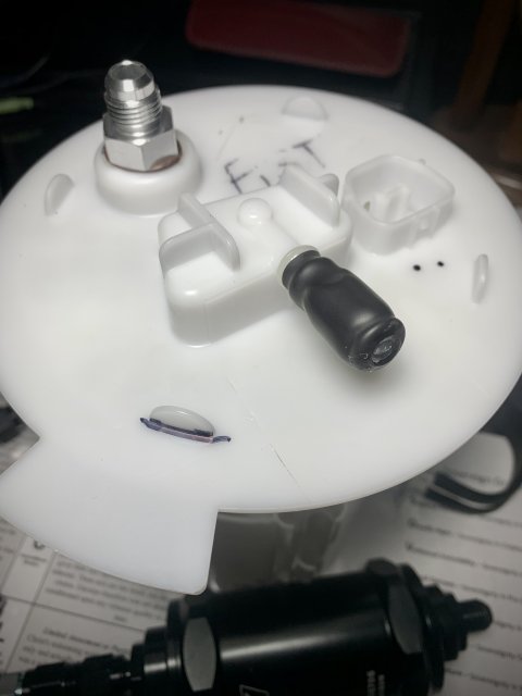

So I sent my fuel pump back to BA for some revision under some concerns that were raised with the model of pump that I originally received. I have an older style setup with the external fuel filter, which I like, and the DW300c, which I also like, that is no longer manufactured. Patrick over at BA was kind enough to settle this for me and work in some peace of mind at potential fail point. It appears solid now and he also fit the system with AN feed and tapped the original feed location to give the option to run a return line system moving forward if I so choose. Here’s the reworked unit...

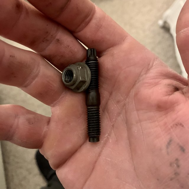

Anyone wanting to source an alternative exhaust manifold stud/nut and unsure of the thread and pitch on these I’ve verified them at M8 x 1.25 - 3/4” set depth. I couldn’t get a sure answer online, so figured I’d share.
I do believe ARP makes them also for the FiST also*
