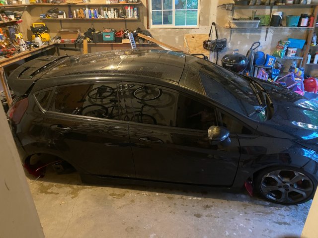

Was able to finally change my intermediate and primary ebrake cable sets. I haven't had an emergency brake for over a year. So that's comforting! Turns out the pivoting arm on my driver's side caliper that sets the brake was actually seized. I think that's why my cable stretched originally. PB and some smacking freed it all up. My heat shield nuts were rusted and going to snap the bolt if removed... So, I had to cut away some of the shield to access the lower connecting point of the cables. Bummer, but it worked. Had wifey on installing new whoosh stainless steel brake lines, that was rad and helpful. Def need to bleed the brakes now. Car is finally off stands and back on the ground after almost 8 months.

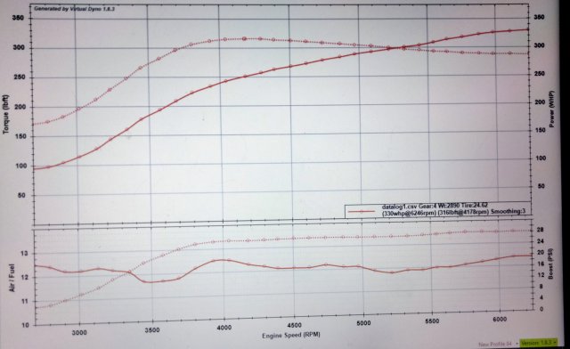

Sent a log to the tuner and received confirmation everything still checks out from previous tuning cycles. Before removing my turbo setup I was seeing boost fluctuation of ~2-4psi and inconsistent fueling. I believe this was due to a turbine housing exhaust leak between the two housing vband. IMO fuel still looks a little choppy but I'm no tuner and if he says it checks out that works for me. I was hoping for quite a bit more power but we cut it off there to negate chances of lifting my already, likely, tired heads. Car now has 117k miles on it. Hoping to eventually throw a built motor in the car and keep the horsepower goals moving forward. Next step is install my new suspension, injen exhaust midsection resonator delete, retrofit projector headlights and some more aero stuff. Car feels good. I'm in the market for new tires here ASAP. My current set are literally slicks from tuning process. I am running OEM wheels... Was considering Nitto Neo Gens because cost effective. Car is only seasonal so could probably get something better... But is it really worth? Car is fun commuter / weekend road toy no track or anything like that. Suggestions or input?

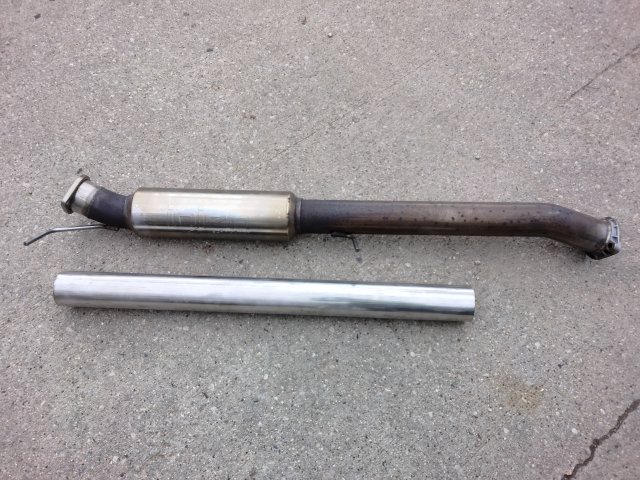

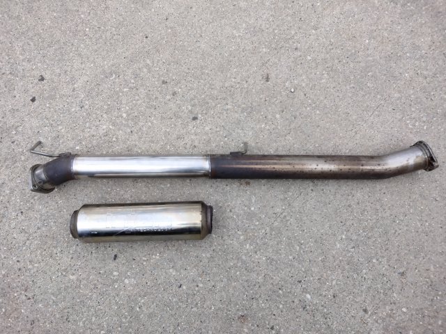

Just had exhaust modified again. One resonator away from straight piped. Peron 3.5" catless DP, Nortech tubular manifold, modified 3" injen CBE. Sounds rad, been wanting to do this for a while now... Have just enough pipe to delete the last resonator. Probably won't do it though... We shall see.

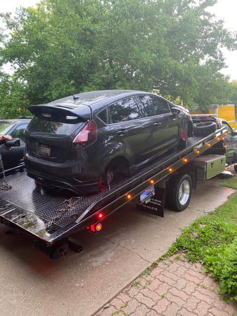

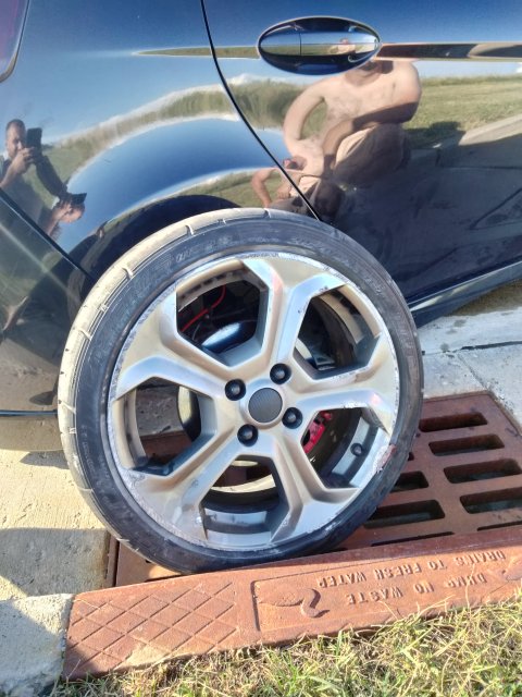

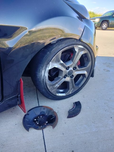

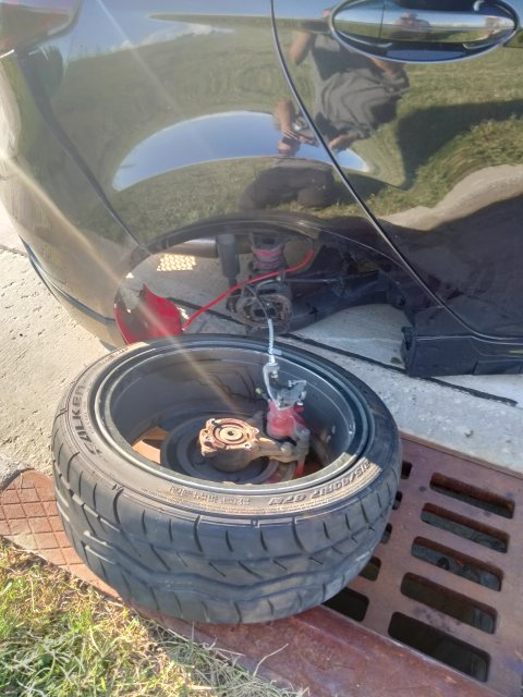

Thread Starter #337

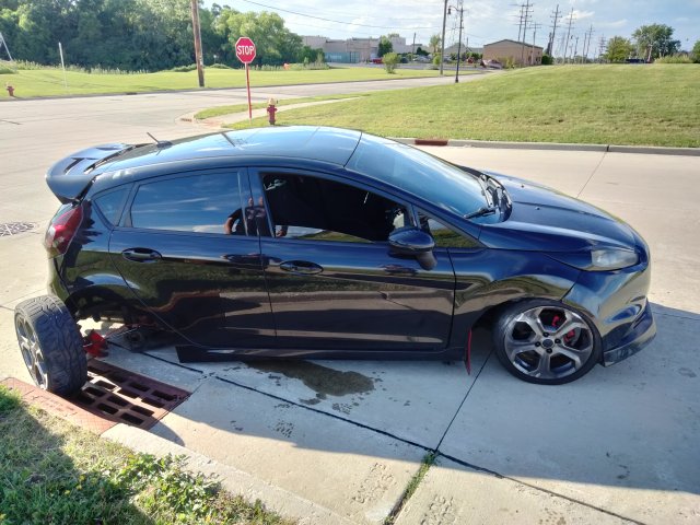

Thank you so much for the concern guys, yeah I'm doing alright. Really disappointed and just navigating emotions really lol. Took a turn too fast and lost control on understeer/torque steer plus I think my passenger side tie rod failed simultaneously... If not then I can't really describe what happened. Per typical accident it all just happened so quickly. Lower back and pride hurt lol. Wife isn't sure she wants me building fast cars anymore for family sake scare... She was shook up by it. Hopefully I will be getting a new fist and transferring the build.. contacting insurance today to assess options.
