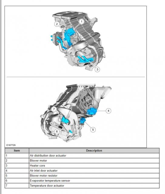

Just found this... Anyone have any experience replacing #7, the Temp door actuator? I wonder if that could be the problem.

UPDATE: I changed the 5 pin actuator on the drivers side, the one that accessible thru the steering wheel lower cover hole. and BAM i got me mode controls back...switching nicely thru vent, defrost and floor!
