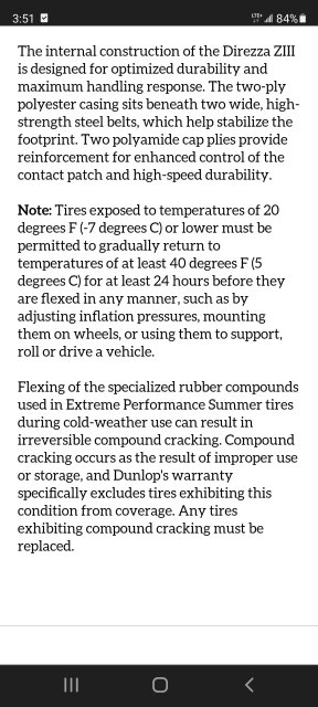

Read what the actual manufacturer says about the tire.
My personal opinion if you live in zone 7B or higher you are not really going to have a problem with temperatures. If you live in zone 6B and under you really shouldn't be keeping summer tires on your car.

That's a helpful perspective, thanks. What tires are you running in the winter? We both live in the Piedmont of North Carolina, which looks like Zone 7B when I look it up.

7B correct, Falken RT660. To be fair though I have other cars to drive. Soon I will be leaving for work at 5:30 in the morning, and my job rarely closes due to weather. If this was my only car I would have an extra set of tires, and I would be using an all weather tire during the cold months.
