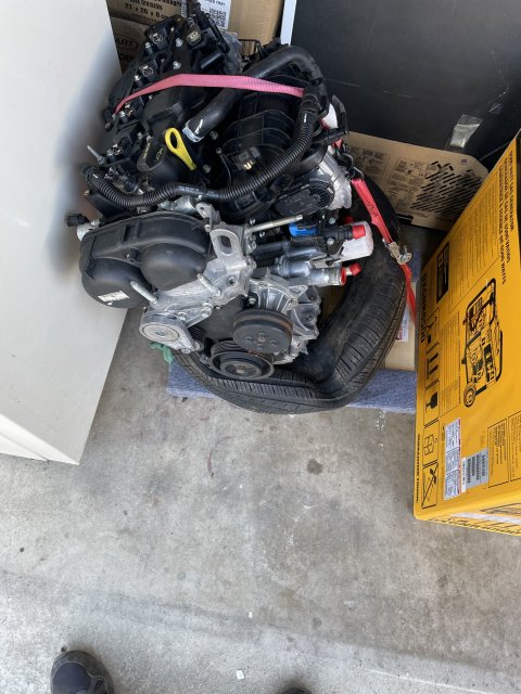

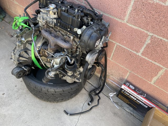

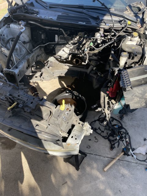

Found an engine from a local junkyard. Pulled out the engine today. Going to order clutch fluids etc. anything else I should order ?
Engine Out: 3CDFD4F0-0E8C-4F56-B279-616ECC2A35F5.jpeg
Old engine :
Replacement Engine :
