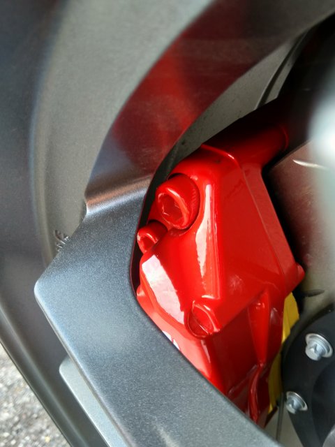

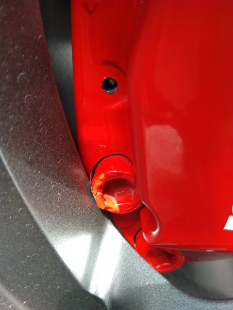

Got the hypergrams wrapped up in some Gmax tires and I've got like 4in of space between the stock calipers and the new 8in wide wheels thought I was all good to install those sweet brembos.... NOPE!
๐Ÿ˜ญ๐Ÿ˜ญ๐Ÿ˜ญ
๐Ÿ˜ญ
I'd say a 5mm spacer should do the trick... Next time I buy 17x8.5 wheels. I promise guys sexy time pictures are next. Nothing worth having is easy.

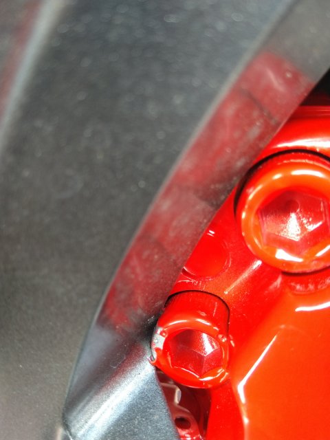

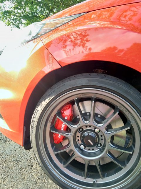

Thread Starter #51
*update*
๐Ÿ˜Ž๐Ÿ˜Ž๐Ÿ˜Ž
It's about 1mm away from the caliper bolt... If it wouldn't fit I was prepared to file the bolts. ๐Ÿ˜จ
๐Ÿ˜…

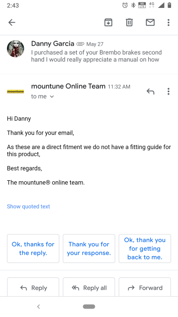

I've tried getting in contact with mountune UK since the USA branch never sold these before and suggested I do that. I've emailed them a week prior for instructions on instillation but nothing. I'll message them again today. Returned the Ray's lug nuts and got some cold forged lug nuts by advan. Rays are poo poo

Big sad... Well these things are made of tough stuff so I'm going to just keep it as is because I don't feel or see any issues with how they are set. Expect a guide later in the fourms on how the install is done... Though these are not sold any more.
