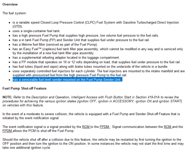

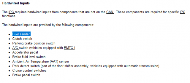

The fuel level sender appears to be mounted on the fuel pump, which is inside the fuel tank.
RCM = Restraint Control Module (seatbelts?)
FPDM = Fuel Pump Driver Module

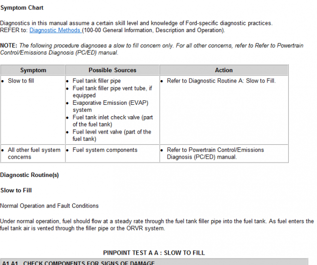

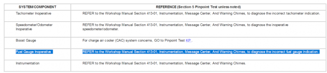

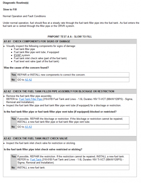

The "2016 Ford Fiesta ST - Service Manual - 413-01 Instrumentation Message Center and Warning Chimes.pdf" is too much to post, so has been attached. But this will provide a diagnostic chart for pin pointing the issue.
