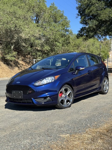

RIDE HEIGHT
As this is my daily driver I didn’t want to absolutely slam the car, hence why I decided to go with the swift springs as they only drop the whole car about an inch all around. Of course you should still be careful on steep drives but speed bumps are not an issue whatsoever. Definitely drops the car enough to give it a good stance and look but not enough where you’re sweating every time you see a bump in the road, below are some pictures that should show a good before and after.
before
after
View attachment IMG_6623.jpeg View attachment IMG_6639.jpeg View attachment IMG_6640.jpeg
