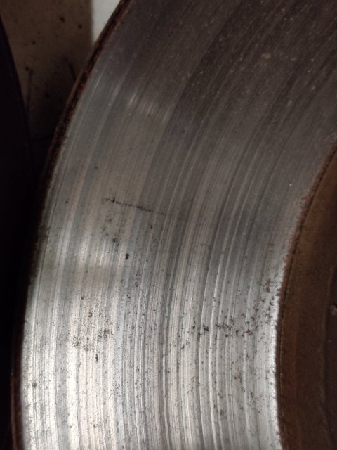

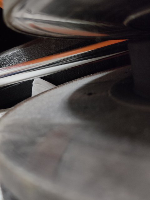

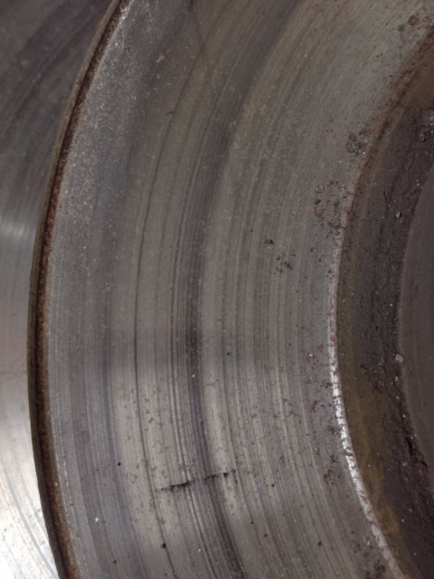

What are we even looking at in that picture?
358R
#13987
75
22
Thread Starter #25
A picture of a rotor, taken with about 3 fingers with hand full of clothes and beer in the other hand. I was trying to illustrate the condition/depth of the previous rotors. Maybe straight on would have been a better angle.
