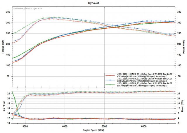

So not trying to argue here, but we done some test of our own and show consistently that Vdyno is off by as much as 30hp as compared to a real dyno. So based on your vdyno logs, that puts you clearly under 300. We did out test recording vdyno as the same time we were on the dyno. And No one has even come close.
Unless you went out to a nice road and tested after the dyno your test was flawed for the simple reason of loading. Loading is different for on road and dyno which is why tuners typically will verify the tune on the road after a dyno and make adjustments if necessary. When I was stock turbo, FBO on 93, my vdyno and dyno were 5-10whp difference.

You're also talking about a wildly different turbo than a hybrid or something smaller (and more useable) than a 2867.... I'm on watermeth / 93 and an S280 hitting 280whp on a v-dyno. The only reason I'm using a v-dyno is to compare to my previous ones (~260whp on 93 alone). 50/50 provided the 20whp.
More useable...as in blow your tires off and have to limit your boost in gear because you have no traction useable? And we both end up making similar power rowing through the gears except I have a better top end...?
Regardless of that, have I not addressed the OPs question? I’m not bound to speak only of hybrids or turbos smaller than a 2867.

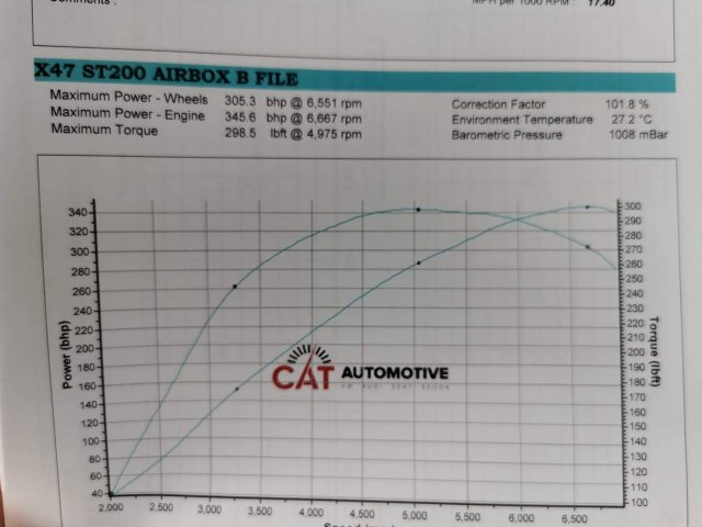

Eu model (stealthwerx) x47r on stock eu fuel with st200 intake and 27°c temp FB_IMG_1597314855928.jpg

With pump gas you will be able to stretch the stock fuel system quite a bit further then with ethanol. EU pump gas is much better then the pump gas in the us, even better then its stated on paper.

I know about better fuel, but we dont have ethanol here, however still nice achivement with x47r and st200 airbox, on such a hot day, he have newest maxd revision (custom for him and i think his customers) for this turbo, and it seems work realy well, his car have 93k miles
