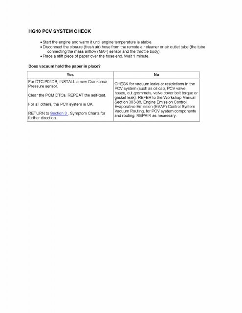

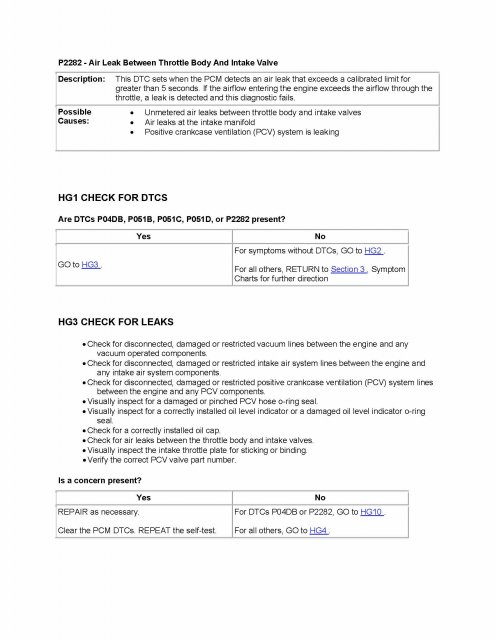

On the last leg of getting my build squared away. Here is what I have noticed. Getting p2282 leak between TB and intake valve. All gaskets when installing aux fuel were brand new but could have been crushed for some reason. I have noticed my pcv line (manifold to head) is leaking oil from the front and the emissions line below it shows oil on it but not sure if that is still the pcv leaking or a different leak. When. I installed the aux fuel kit from peron, I left the fuel line off. now that I'm thinking about it I feel like an idiot cuz it's a giant hole essentially in my intake but maybe I'm wrong? Is there a check valve in the fuel rail? Just trying to validate my findings. Would the fuel line being disconnected contribute to a vacuum leak for aux fuel?
