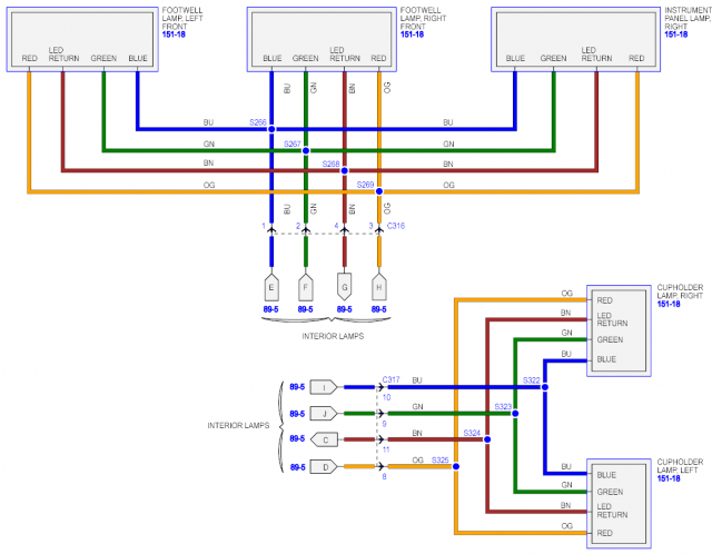

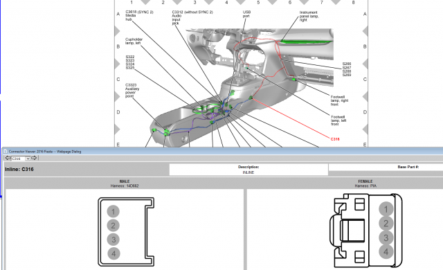

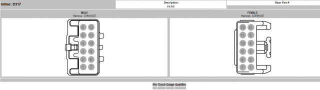

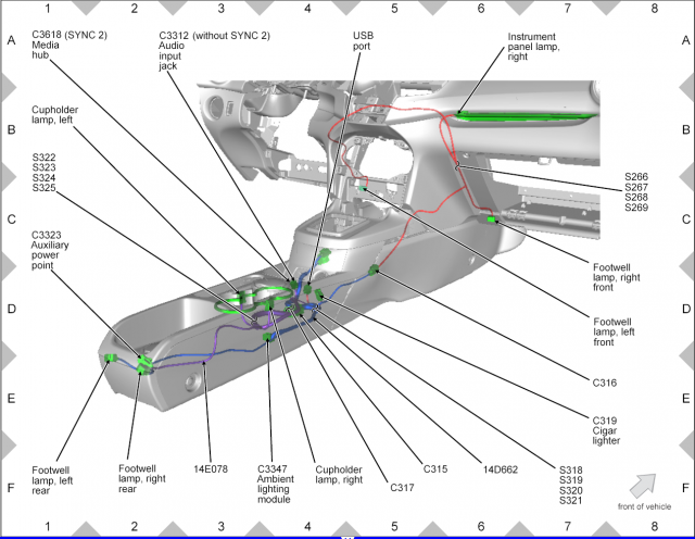

Looks like you'll want to take a peek at Connector 316, 317 and (maybe) Splices 266-269.
It’s hard to tell during the day but I believe it was just unplugged. I plugged it in where the connectors meet on the center console. It looks like it works, I’ll find out tonight
