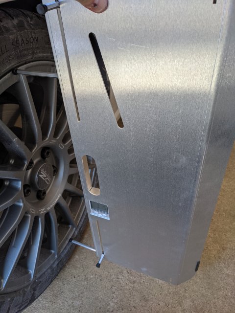

So I ended up using some Summit Bucks and drove to Summit today and bought the Tenhulzen Toe plates w/ a built in camber gauge (not my photo but example of what I got)
I am going to install my new shocks, springs, and sway bars on my Scion this weekend and play around with these toe plates to check and adjust alignment. I'll report back my thoughts on these.
I know this is not nearly as good/ideal as a "string box" setup, but I didn't want to spend a lot of money right now and these toe plates will be nice to throw into the trunk for test and tunes and track days.

Finally got around to playing with these last weekend.
I installed my sway bars on my Scion and checked my alignment using the Tenhulzen plates. They are pretty easy to use. I am going to try and use them to adjust my alignment maybe this weekend, we will see.
So far pretty happy with them. Will be a nice item to throw in the car for events.
Alignment is out of spec based on what I told the alignment shop to do last year.
Going to dial in -3* Camber up front with 0 toe, and -2.25* in the rear with 1/16" total toe in.

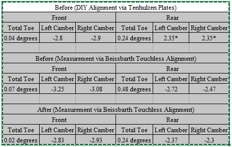

UPDATE:
I set my alignment this weekend using the Tenhulzen plates on my Scion. Here is what I ended up with:
Front - 1/64" toe in, -2.8 LF and -2.9 RF
Rear - 3/32" toe in, -2.35 Camber both sides
I am going to schedule an appointment to have the alignment checked on a super fancy rack near me sometime in the next 2 weeks. More to come!

Got an alignment today on my FRS using a Beissbarth touchless rack. These are world class racks, only 3 in the country right now. I'm lucky one is 15 min from me.
Here is an interesting look at before (by my toe plates), before (as measured by the Rack), and after
