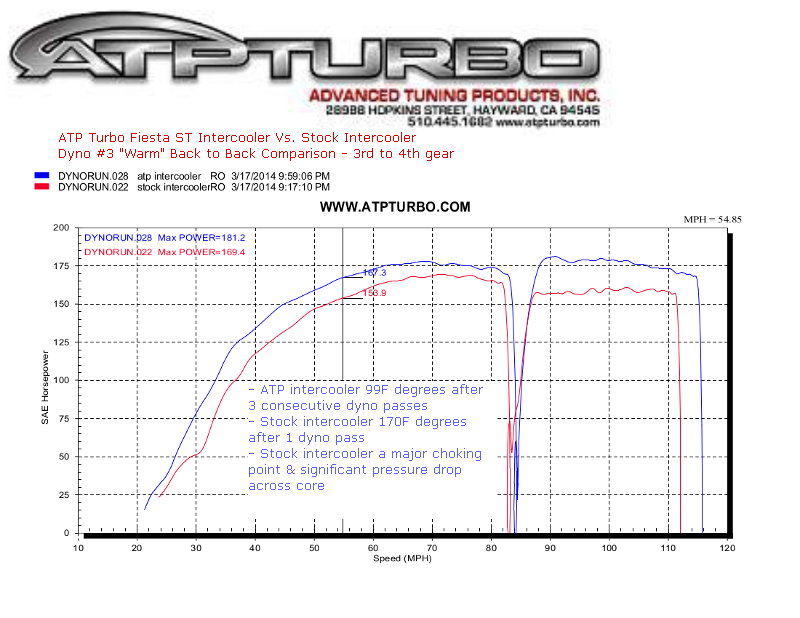

They're saying if you don't plan on upgrading to a bigger turbo then don't spend the money on the charge pipe. The turbo outlet is where it's smallest, hence it's the restriction, not the piping. If you're going bigger turbo at some point then for sure make everything at least the same size as the turbo outlet which will be 2"

Please note: If you don’t have plans to upgrade to a larger turbo down the road, we don’t recommend spending money on this part as it’s not necessary and there isn’t measureable gains to justify the cost. The choking point is really the turbo outlet itself at 1.5” OD and a bit over 1.25” inner diameter. You will be better served to put the money towards an intercooler upgrade as that greatly enhances the operation of the stock turbo.

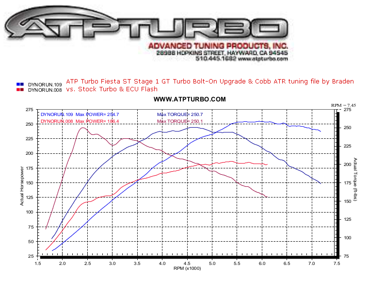

Looks like they've run a 12.9 @ 106mph with a GTX turbo and slicks [cool]
