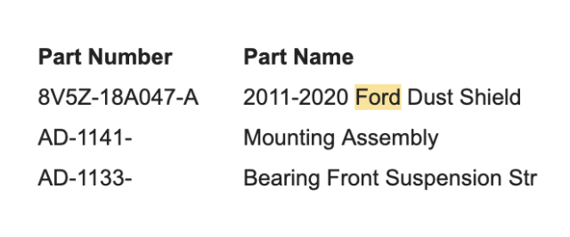

#8027
801
477
Thanks! So, I'll probably end up grabbing the KYB front and rear mounts, but after that, that's two 8V5Z-18198-B and two 8V5Z-18A047-A... do I need the "bumpers" as well? And then nothing for the rears, since it looks like the rear boots aren't sold separately without buying an entire strut assembly?
#1878
507
400
Front ones - no; B14s have internal bump stops
Rear ones - yes
Yeah, that's why I took off and reused boot/bumpstop combo from the OEM shocks. AFAIK you can put together a comparable combo with differently styled boot from KYB offering but I don't know which are the right parts.
Anecdotally, another FiST owner got KYB front mount/bearings and one broke on him during an autocross event (I think the rubber detached or something like that). If you have an opportunity to get OEM ones, I'd do that.
