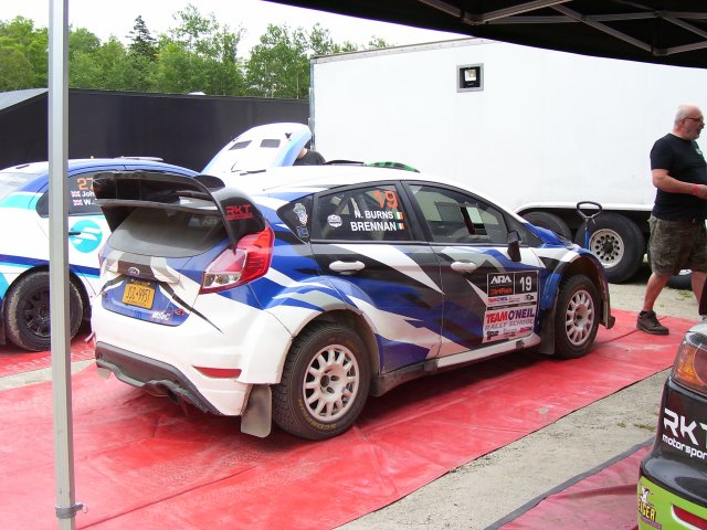

Very curious if he went 4G63 or Focus RS or something else for the powertrain
The whole Evo Ralliart drive train/power train installed into an S2000 rally class Fiesta unibody is a popular conversion done in Euro/Eastern European national rally circles.
But, that S2000 Fiesta unibody is already set up for an AWD drive train. [wink]

If I were to commit to awd fist I'd use Evo 3 drivetrain. I believe it's the closest to our cars.
That is PRECISELY what some are using for the 'Proto' Mk7 Fiesta rally builds, mainly in eastern Europe, but a couple here in the states, competing in the Open AWD class in ARA rallying. [wink] [thumb]

Its still nothing to sneez at.... but... RKT builds turn key 5 door Fiesta Proto cars for $125K. Now waiting for M-Sport fan to chime in lol
Yup, I've started many of them while working start controls on ARA rally stages.
But, albeit driven on the open to the public roads for the transit portions of the rallies in between the all out, full speed gravel stages (to get to said competitive stages), they are nowhere near 'street legal' technically, anywhere in this land, and pretty much impossible to insure for steady, constant, everyday public road use. [:(]
Now, an area which has no inspections whatsoever, will register the car according to the VIN plate number, but one had better HOPE that the insurance company does not require an inspection before issuing a policy, OR that one never has to actually use said insurance if they do happen to issue a policy with no visual inspection at the time of policy application. [wink]
