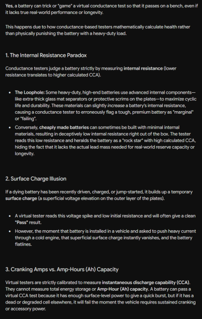

Battery measured 12.72v upon receipt. This is identified as a Start/Stop battery rather than a traditional starting battery. Instructions say not to install if it's not reading >12.6.. The documentation has proper English, very detailed. It quotes an 8% drop every 90 days. The documentation leads me to suspect this could be a quality product. IIRC the documentation claims thicker glass mat for better durability.
There is no date date on the battery. A code stamped onto it, has no obvious translation. The short-sides of the battery have an obvious bulge.
Because a battery can be charged right before ship I wanted to load test the battery. Looking into those, they are cheaply available. The load testers however do not actually load test the battery. They send a small AC current through the battery to measure internal resistance, then calculate possible load handling capacity based upon the results. There is a cranking test which presumably measures voltage drop while installed in the vehicle. Obviously it's neither cold and the engine won't generate anywhere near a 600 Amp load. So I guess there isn't much of a point. I doubt the local parts stores still have the old style load testers, that actually generated a load for the battery.
Some batteries require "activation" before use or ship. IIRC that helps minimize the need for maintenance while stored. Consumer documentation makes no mention of this.
