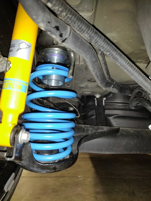

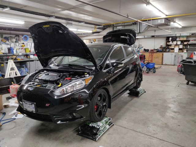

Installed couple of days ago on a 2018 with less than 7k and I'm overall pretty underwhelmed. Rebound seems alright but damping seems very weak. Rear springs feel like butter till I hit a bump or pothole then my spine is getting dislodged by the bump stops. Stock just felt better. What gives?
I torqued everything correctly under load, made sure the rubber mounting tension of all bushings in the system were released.
Just sad. Lots of effort for blah results. At least it looks better. IMG73.jpg IMG_20200324_173105.jpg IMG_20200324_173029.jpg IMG_20200323_155344.jpg IMG_20200322_134942.jpg IMG_20200322_133739.jpg IMG_20200322_132622.jpg

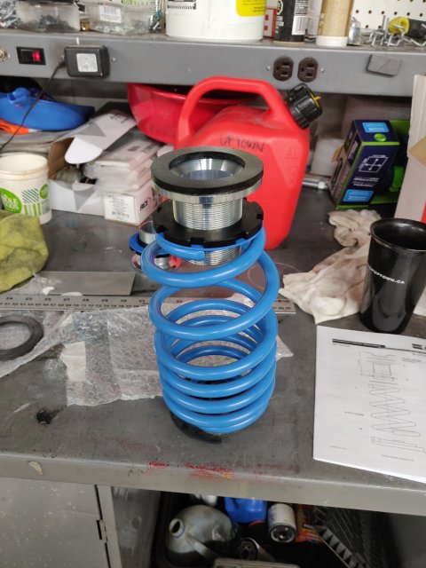

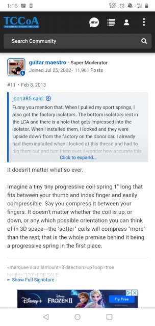

Not sure how your rear springs are supposed to be but mine are flipped the other way. Mountune Clubsport
#9684
48
18
Same here with swift springs my coiled up part faces upwards while the springs with more space between them went downwards. Yours may be backwards bud

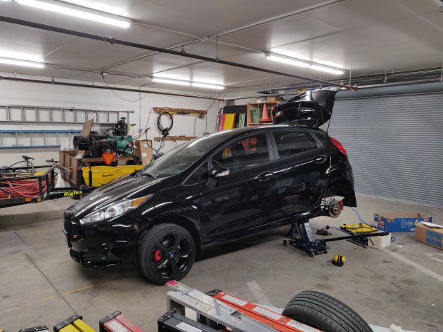

Please buy some ramps that looks crazy unsafe!

Also your rear springs do look upside down. The instructions suck so I don't blame you.

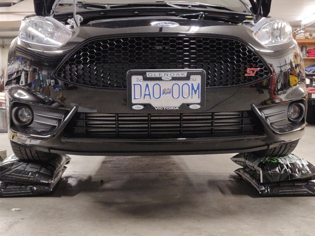

First up those sand bags are just to load the suspension while I second torqued fasteners. There are jack stands under there set a little lower to stop this face getting any uglier than it already is.

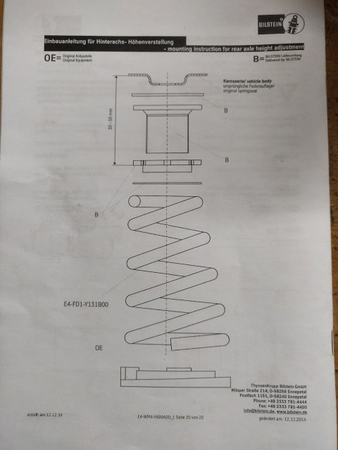

As far as spring orientation I was trying to figure this out also but the included instructions explicitly stated that the correct spring orientation is achieved by having the Bilstein logo printed on the spring facing up, so that's what I did. It does look wrong though so I dunno. Can someone else with these take a look under theirs for me?
Edit- orientation doesn't matter. See attached screenshot.

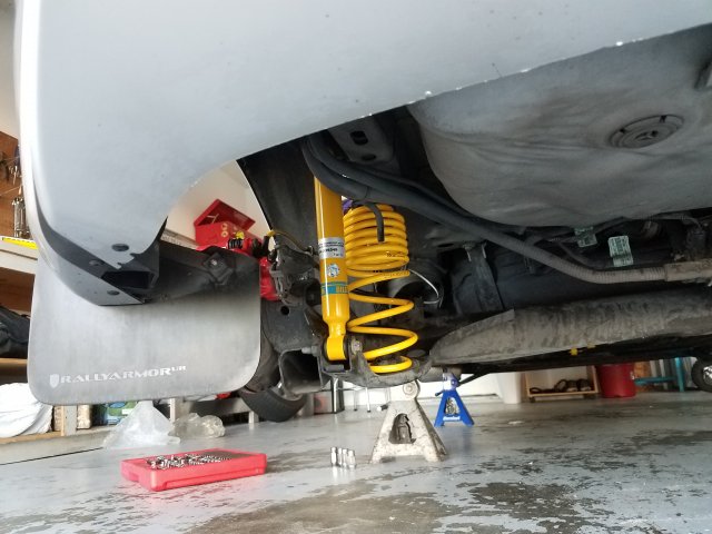

The extra effort came from sourcing the extra parts a couple of times. I bought some camber plates from the UK that had shock nuts with the wrong thread pitch so I sent them back then got new plates that ended up not fitting anyway so I went back to stock topmounts added to the bilstein 'torque everything under load then loosen all rubber to metal attachments to relieve tension' just a pita for it not to be better than stock.
Might switch to adjustable KWs. 15855030278739010192619308614542.jpg 15855029686196127148611293779525.jpg
