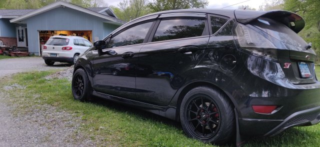

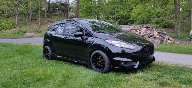

. This is mine with swift spec r springs and B6’s. A couple years ago I was able to score the B6’s on Rock Auto for about half the cost of everyone else. Definitely worth looking into. Ive had this setup for a couple years now and am very happy with it. Running R888 tires now though. Tires and rims in pic’s are 15x8 Dekagrams with 205/50/R15 Federal 595 RSRR tires.

Looks good, I was expecting more gap, but you’re also running 50 sidewalls tires. I’m curious what the measurement is from the ground to the center of the wheel arch lip on yours.

Thanks. Id get you those measurements but the car wont be back together and on the ground for a few more weeks. When and if i remember ill put those measurements up for you.

That wheel well gap would be MUCH less if those were 205/50-16s, or even 215/40-17s.
