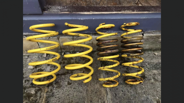

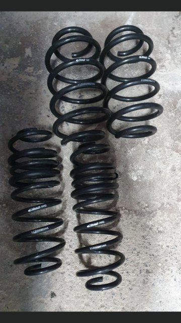

It looks to me like there may well be different Eibach pro springs that were available for the fiesta St.
This is a photo of the ones that I have:
As you can see, these are linear in the front and progressive in the rear. They also look identical to the mountune springs:
CC433C3F-66A4-4001-99B1-391AB9503ED6.png I believe that the springs are very similar in spring rate being about 5% stiffer than original springs.
Eibach also offer a redline spring which is 35mm lower in the front and 40-45mm lower at the rear. These would definitely be too low for me!
I’m not sure what rates these springs are, but from reading forums they seem to be softer than the Eibach pro kit.
It looks like there may be different Eibach pro springs in the UK and US market.
