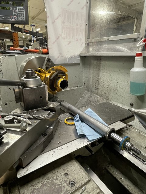

OPened up a B6/B8 front strut for science. Nothing useful. Can't even retrofit the parts to make the custom inserts I use fit in that off the shelf housing. So I guess I will just continue to build my own housings.

Yeah, it appears these front struts for out cars are a twin tube. Its odd though, I put B8s and Swifts a Focus ST a month ago and they were a nice inverted strut that you could totally rebuild, modify the housing, etc. I have some E36 M3 struts here in the shop that I revalved for race use and they were a proper insert strut housing. Not sure I understand why Bilstein decided to go down this path with the Fiesta parts.
