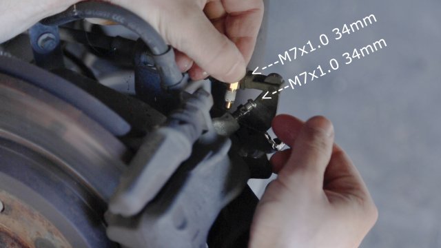

I was looking a few months ago and wasn't able to find this, so just I case anyone was wondering here are the specs for the ST brake bleeder screws if you ever need to replace them. Also, if you need the Speed Bleeder version or want to upgrade, the part numbers are here as well. I am not affiliated with Speed Bleeders I just think they are a great product to make brake bleeding simple and fast.
Rear: M7x1.0 34mm part# 639570 $12 a pair
Front: M10x1.0 33mm part# 639630 $12 a pair
I am currently trying to get them to add the Fiesta to their website database so as of now you'll have to call with those part numbers to order.

Looks like I was correct on the specs for the FiST. It seems like there might be more then one configuration for the FiST but Speed Bleeder is informed of this and they will be adding this configuration to their database. My configuration is as follows:
2015 Fiesta ST
Front: M10x1.0 34mm Part # SB1010S
Rear: M7x1.0 34mm Part # SB7100S
In their database they had M10 on all 4 corners, so make sure you check the configuration on your own vehicle before ordering your bleeder screws. It looks like there are only two possibilities luckily.
I am making a video that will be out soon, and hopefully having these specs posted helps somebody in the future. Remember to measure before you buy, just because a company has a size listed doesn't it is 100% true for your specific vehicle, not everyones FiST is identical.

I don’t think you are understanding there is a difference between a specification and a part number. The specification has always been correct and this can be used universally for anyone needing a bleeder screw from any manufacturer for the FiST. This spec is very useful and was not posed for others to see when I created this post.
And the PART number you are referring to is correct for ordering Speed Bleeders on the Russell Website. Which I recommended because they only sell the SS option of this Speed Bleeder and I felt like it was a more accessible site then the SB site but after talking with the folks at Speed Bleeder and them mentioning they would add the M7 spec as an option on their site I chose to add their part numbers since they have been so great to work with on this project.
The one I posted recently has the Speed Bleeder part number next to the spec. They are both correct part numbers. You didn’t even know what the thread size and pitch was when asked earlier in this topic.
