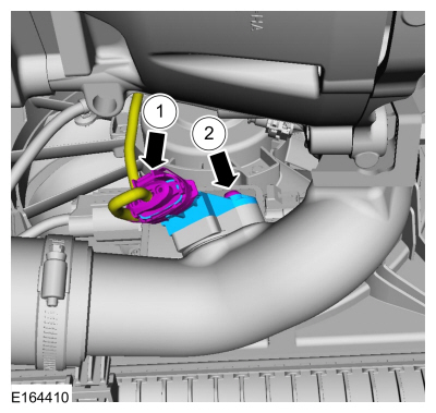

Check the CAT (Charge Air Temp) sensor is tight. I had a TurboTransformer installed for a bit, and when it started to shit the bed it gave me symptoms similar to the noises you're hearing.
SoCal heat had started to warp the housing (of the TT) creating intermittent contact at some of the pins for the CAT sensor. It resulted in a loss of power, intermittent surging and turkey gobble. Once I removed the TT, and left the battery disconnected for ~10 minutes all was fine again
Where is this sensor located?
