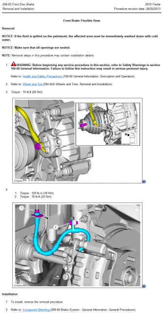

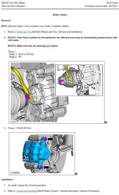

Front caliper mounting bolt torque is 19 Ft-Lbs.
Image from Service Manual is here...
https://1drv.ms/u/s!ABsZJDCN8kMMgaRF
I was thinking the 52 Ft-Lb was being quoted as that value but went and looked it up in my manual after thinking that number was quite high.
Be careful not to mistake what torque goes where. Make no mistakes with brakes, as breaks with those mistakes are not guaranteed.

Since we seem to get conflicting info out of the manual, may have to go by feel. 🙄
Pay attention to in-lbs vs ft-lbs. I've broken a bolt on a prior car, not paying attention.
https://www.omnicalculator.com/conversion/inch-pounds-to-foot-pounds
I did look for general torque specs where they specify torque, based on bolt head size. Didn't see that in the manual. May or may not be in there.
