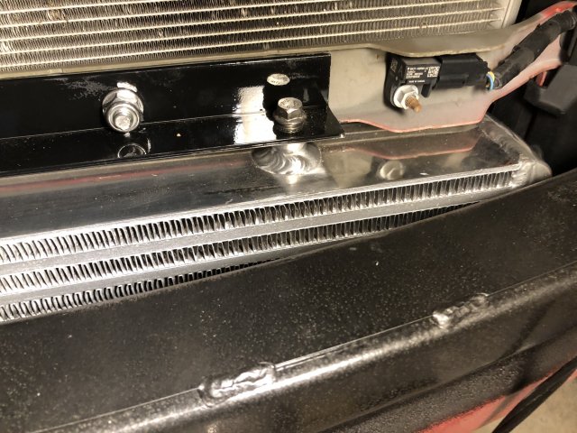

I just did mine last night and the fitting was a bit funky. the black bracket that attaches it, in your picture it went behind the bar. for me it was physically impossible to do this, the back of the bracket wasnt tall enough and the holes were too low, so I had to place it in front. huge pain to tighten down this way. but it's on.

So TyphoonFist had the original mounting bracket. We updated not long after so this install is similar but not entirely the same. The bracket goes in FRONT of the crash bar, slipping into the channel where the crash sensors reside.
The description on the website was updated when we put out the new bracket design. I should've made a post though! Feel free to message me with any questions.

hey just as some constructive criticism since the mount is now in the front. the black paint on the mount, to put it nicely... kind of blows, it starts to flake really quickly so it kinda looks trashy atm. I'd say either just leave it raw
Feedback appreciated!
Unfortunately, we left it raw in the beginning and had much more complaints. Adding powder-coat options just would cause an increase in price as well as delay in shipping. The whole idea of releasing this intercooler was to have the BEST bang for buck option out there. And so far, we still are.
I'm sorry about the paint. I will certainly look into more options. I hope you are satisfied with the core performance otherwise though!

oh the intercooler is great I have no complaints on its performance. the bracket was my only small grip. maybe offer the option to to powder coat it for an increased price and delayed shipping, some people might be ok waiting a bit longer. idk just thought I'd mention it. great product overall tho
