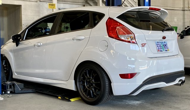

I’m currently building my Fiesta slowly so I can road race, autocross, and hillclimb all while being able to DD it(for now).
Car is currently stage 2 fbo
Power I plan to stop at an S280 with aux fuel and upgraded injectors and pump. Gonna do a radiator, coolant tank, catch can, oil cooler, and on the fence about upgrading the cold side.
Suspension is what I’m mainly what I’m wondering what I need and don’t need. I’m not looking to build the most competitive car, I just want things to compliment each other and eliminate weak points etc.
Meister R coilovers, front and rear swaybar endlinks, strut tower bars? Front, rear or both sway bars? Toe links? What chassis bracing is actually worth the money?
Wheels/tires I’m already running Konig Hypergrams 17x8’s, but have been debating going to TD’s 15x8’s with meatier tires.
Brakes whatever bbk fits 15’s or my 17’s if I stay with them. Pads something in the middle with fairly low dust. I know a lot of people run different pads front and rear.
Interior gonna delete the rear seats. Idk if I wanna throw a whole delete kit in there.
Trans do a coolerworx shifter, lsd, and I think that’s all I need?
What am I missing?

The car has lowering springs/struts, endlinks to get proper geometry, front camber bolts, and has been aligned accordingly.
Tire pressures are what they should be. It’s a crucial part from my understanding so I’ve always been on top of it. I’m also a tech, and was a Ford tech for a few years, so I over maintain my vehicles if that’s a thing.
I’ll figure something out for my car as a class near what I want to do.
