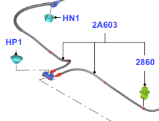

There’s a shop manual procedure for adjusting the parking brake. It’s not hard. Time consuming because you need to get above the exhaust and take the heat shield off.
#4881
4,098
2,632
#30
@Peterson - Looking at the diagram that @koozy posted, that would be at the balancer. Keep in mind that for the typical system with automated adjusters, that procedure is only necessary after having replaced the cables. Otherwise those adjustment points are not to be messed with.
What I don't know is, whether or not we have automated adjustment for the parking brake system in our disc brakes. I would be surprised if we didn't. I'll have to remember to take a closer look, next time I take the wheels off.
