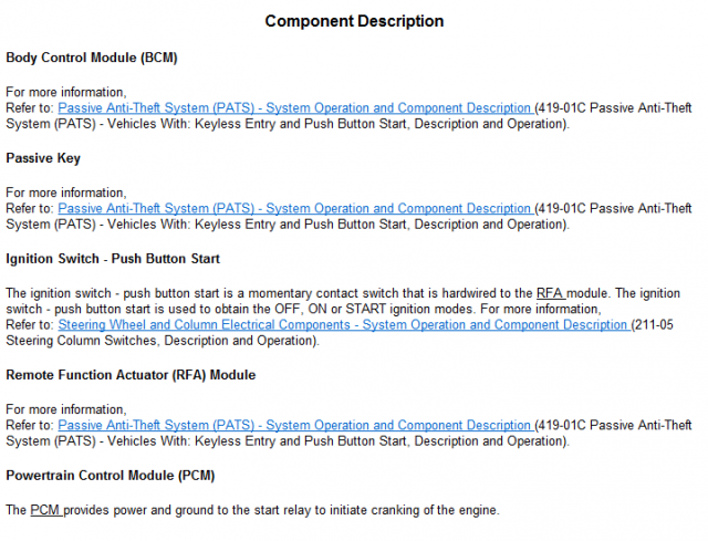

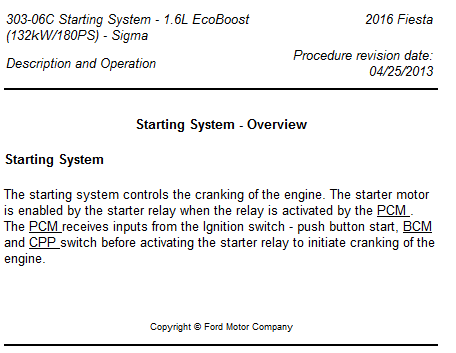

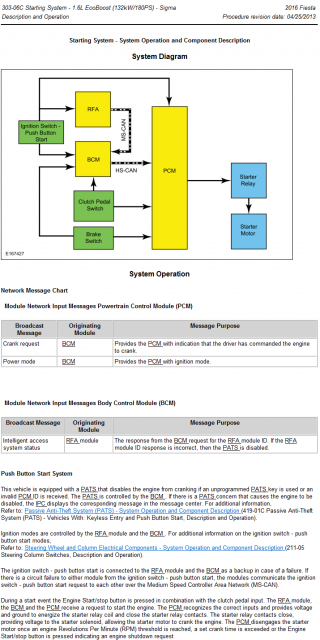

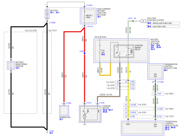

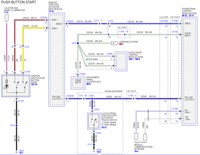

πŸ€” May have meant RFA module?
Wonder what codes were in the system for the BCM to have been suspected?
Ah, I see in the description...
... I didn't see the BCM in the diagrams ...
Clutch switch below shows as BCM and PCM, but above is RFA?
More info...
