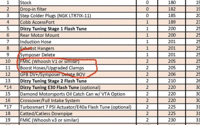

You don’t have to agree but I proved my point. I never said they increase horsepower specifically but that professionals had recommended them to me when I bought my Whoosh V3 intercooler and aftermarket tunes. Jason’s power ratings in that chart are based on the upgrades that he tested and researched. Which means, to get the most out of that tune, aftermarket hoses and clamps were proven to be beneficial.

Using that logic, so then are exhaust hangers
Not to be rude but that’s not at all a reasonable comparison. I’ll say it and show it again - to attain Jason at Dizzy’s stage 2 tunes, he lists hoses and clamps as a must. All of his tunes have been tested using various components. He narrowed them down to the essentials. Hoses and clamps being one of them. He’s more of an expert than 99% of us here. The attached pic is directly off of his website.
To be fair, exhaust hangers are also on the list that you shared.
That list shouldn't be thought of as the only way to do things. Just saying.
I actually agree with you. But the original disagreement was that I was out of left field with my suggestion with multiple people pointing it out. I just wanted to show that there are experts that agree with me.
You’re right.
There is a theoretical advantage in that high performance boost hoses are supposed to resist “growing” or ballooning out under boost as they are reinforced more than the stock hoses. Ballooning hoses would also increase pressure drop. But the degree to which this actually occurs is debatable and would very likely be much less than the difference due to an IC with a much larger internal volume.
This is exactly how it was explained to me by multiple people.
